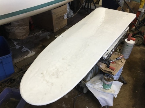

It has been a while since I updated things, of course, that is because I have not done much with the keel over the past 4 weeks. Today, I did the epoxy fairing and fiberglassing of one side of the keel. I will let it cure and then do the other side within the next week or so.
Here are a few pictures from the keel fairing . . .
I pre-cut the fiberglass cloth to the shape of the keel along with the edge and corner cuts.
The game plan is to:
Lay down a coating of the epoxy mix filling the pits and makings a thin layer over the whole surface area.
Apply the fiberglass cloth and roll it into the fairing
Pour on another layer of epoxy mix to then seal any exposed glass. Let cure.
Here is all my 'stuff' . . . Epoxy & Hardner, Adhesive Filler, Roller, etc.
Here is the first layer of filler spread out over the keel.
Here are a couple of pictures after I applied the fiberglass, rolled it smooth and then topped it off with an outer coat of epoxy mix.
I was not too sure how well the edges of the fiberglass cloth would wrap around to the underside of the keel. It seemed to work out OK.
I mixed the epoxy and filler to a moderate consistency, so that it would have decent leveling.
I have a heater underneath the keel to get the temperature up. My garage is at about 48 degrees F and the heater raises the keel temp to the 55-60F range. I used the 'Fast' hardner, which is intended for colder temps.
Anyway, so far so good with the keel coating.

Morning update:
I left the heat on the keel all night and it did its initial cure in a few hours but still had a slightly tacky feel to it. The 4 oz cloth imbedded into the thickened epoxy really leaves a nice level surface to the keel. So I am pretty happy with the results, but tam thinking about how to do the other side.
My main concern about using the fiberglass cloth is that I don't want to build up too much thickness. So, the first layer I wrapped the fiberglass cloth around to the other side about 1". When do the flip side of the keel, I could do the same, wrap the cloth around to the opposite side about 1". . . OR . . . I could undersized the cloth so that it slightly overlaps the existing cloth but does not wrap around to the other side.
My concern in wrapping both sides around is that I may make the leading and trailing edges of the keel too thick.

I would wrap it around. running it into the sand and shoals will skinny it back up again.....

Thanks for the input, Scott. I flipped the keel over last night to start prepping for the other side's work. Based on how it looks, I will take your advice and wrap it around. The thickness does not look to be too much, since it is 4oz cloth, and an extra layer on the edges should help in wear resistance, etc.
