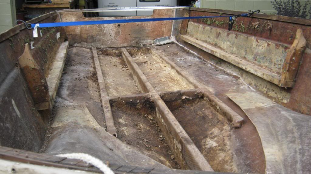

Well today was a good day to finish taken out foam and some more soggy wood,now I think I need to belt sand or grind the rest of the transom
So which should I use marine plywood or regular plywood
One of the guys helping me wants me to paint it while we got it in two pieces and I know this is getting ahead of myself but what is the procedure.So you all know I am a house painter by trade so the tools won't be a problem
Will also need info on fiberglass in a while,Thanks for the help

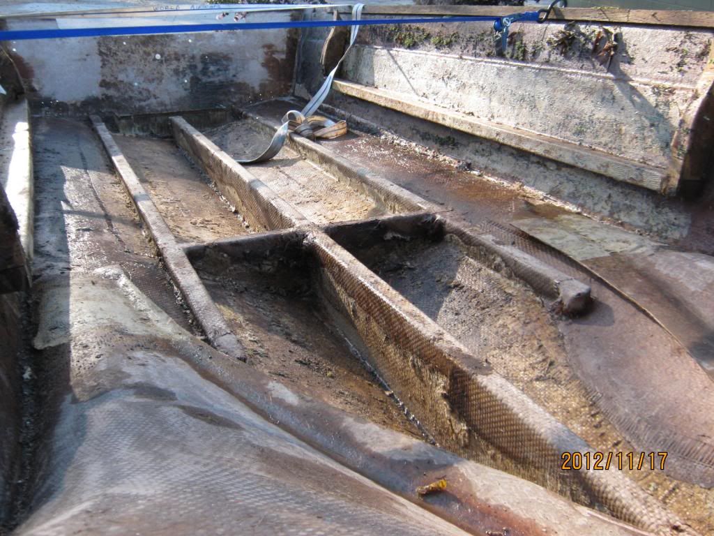

It is hard to tell in the picture but do those stringers have glass on them? It is shocking to me that they are still solid. The stringers in my '72 were so saterated I was squeezing the edge and water was coming out. The glass work was laughable. I will be following your restore as I am restoring mine now too. But you already have more done than i got done all summer.

Yeah electric the stringers do have glass on them and they are solid I drilled holes (4th post) at the bilge so any water in the future would go where it was supposed to go I thought I would need to replace the stringers but to my surprise so far they look good (until someone says different). I also have a good supporting cast of characters by trades house painter(me) carpet installer(his fork truck and place where we work on it) a minuteman press guy(walking buddy) and a computer dude(the smartest out of us all).
The boat is a "77" with an "87" motor on it it is the kind of boat that my Dad use to take me when I was a wee one bought it for 300 and put 1200 in it 4 years ago and she seemed to be a little heavy this year so at the end of our season said to mrseagle that we needed to do this so here I am learning how to rebuild a boat and surprising so far it has been fun

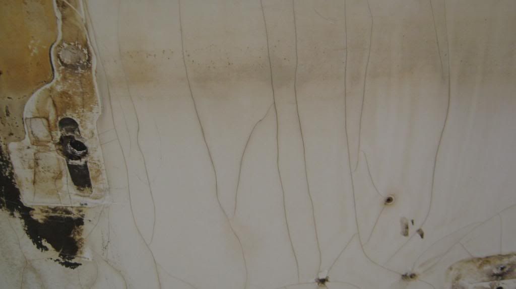

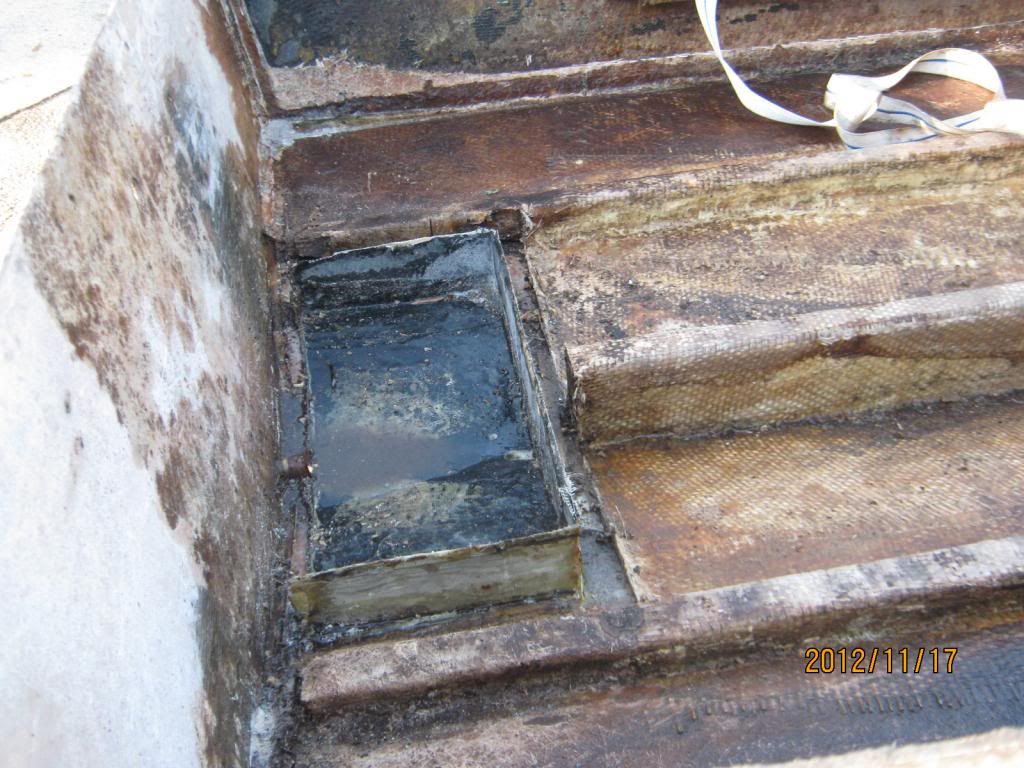

Well I sanded the transom down again,removed a bad stringer and washed her down
That was bad stringer at the bilge
Tomorrow scrape any left over foam and vacuum,cut new stringers make a template that is if mrseagle doesn't have other plans

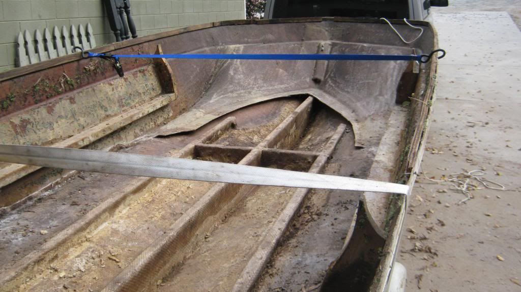

Ok guys we finally got some better weather and was able to work on the boat today,made a template for the transom and the bow today HD carries the Arauco exterior plywood but of course it is a couple of towns over so hopefully I can make some time to get there .
The question is after I repair where I cut through the fiberglass taking out the deck should I put the transom and deck in then flip it over to paint the underside or flip it over after the repair and then put transom and deck in.Thanks for your input

I watch your thread but see no reply to your question.. which is a good one. I dont know but I would think you would want a nice strong transom in at least before you try to flip... ?
Good luck!

I'd get it all in before the flip. Stringers, Transom and Deck. A little heavier but... No worries about flex etc. If you got 3 buddies and a case of beer you can flip her really easy.

I have a fork-truck LOL thanks for the advice just got the wood for the deck and transom went with the Arauco plywood,another small question we are going to cut it out tomorrow (Saturday) I think I read that we should make 2 of the transom and epoxy them together just wondering if that is what I read. I will try to go thru some old post to make sure and as always thanks for all the advice Jim
