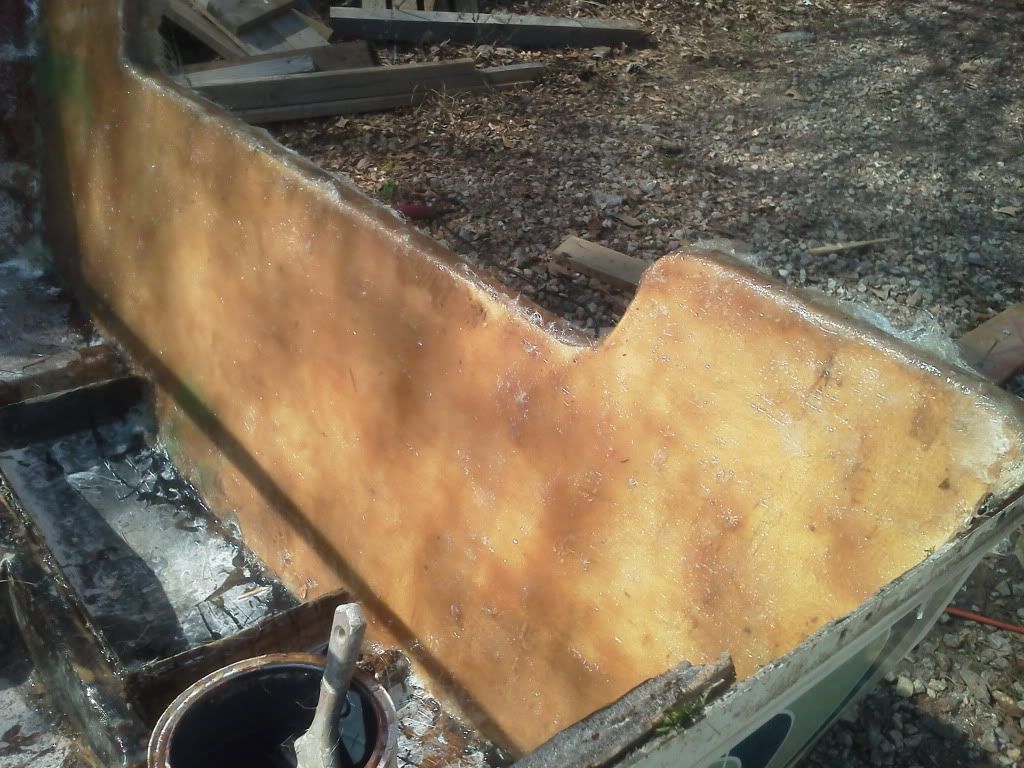

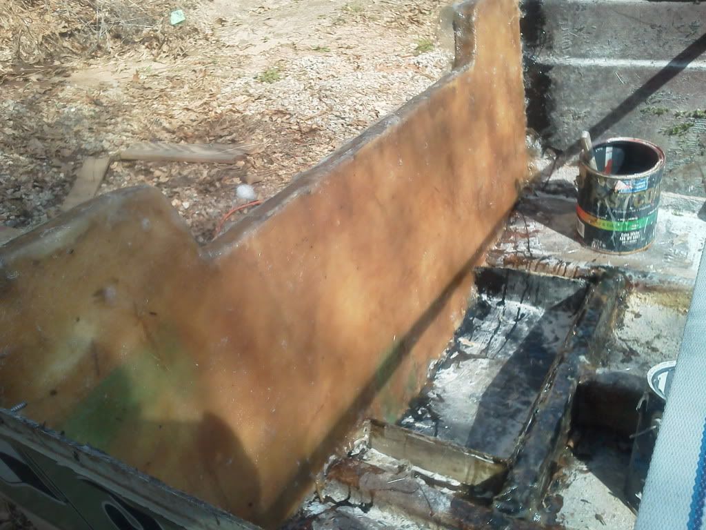

Well it was a great day for glassing got the transom done had one air bubble that I will have to fix but at least I am getting better at glassing

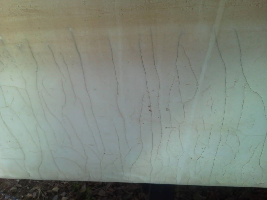

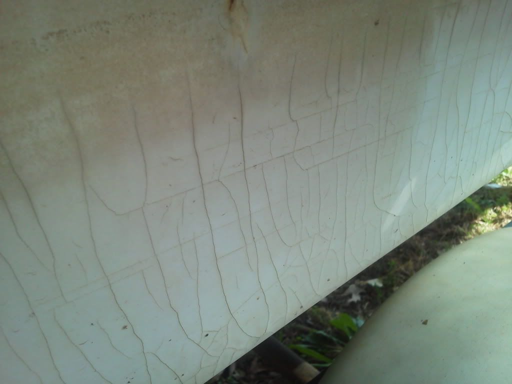

next thing I am going to do is sheet foam and install the deck,I was thinking should I do that then put the top on then tab it in ? thought it might be easier to get the top on before I tab it in. I am going to take the top off again after it is tab in have some electrical (lights etc to fix) and one more thing these pics are of the hull I am guessing stress cracks I am planner any input is always appreciated .
