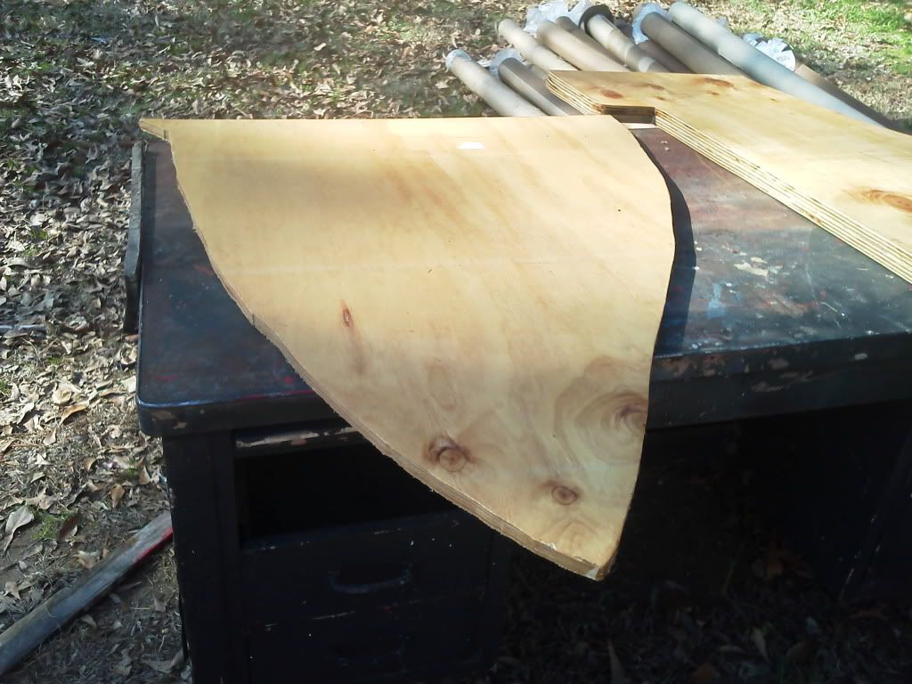

I replaced a couple of stringers,but 95 percent was good the glass did the job not letting the wood rot as you can see I am ready to do some resin I guess? Weather is going to be great so I thought I would fix my slices and work on transom and deck. I used the arauco plywood so I wanted to know which resin to get I think the poly Thanks Jim

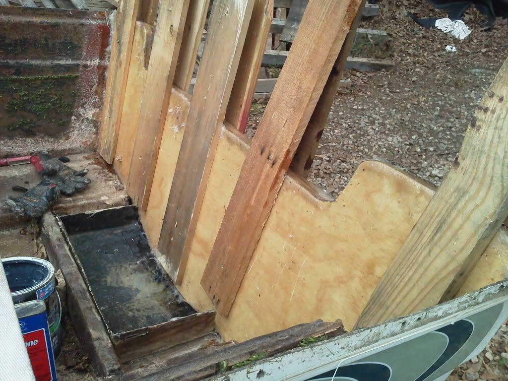

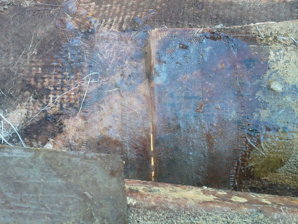

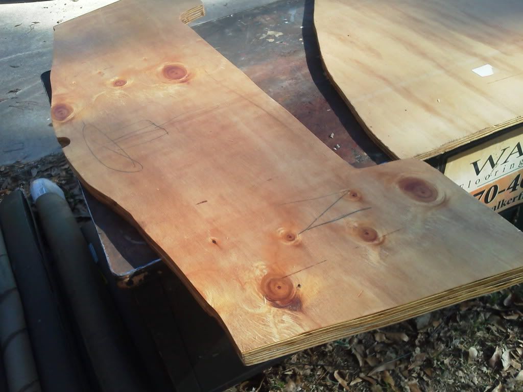

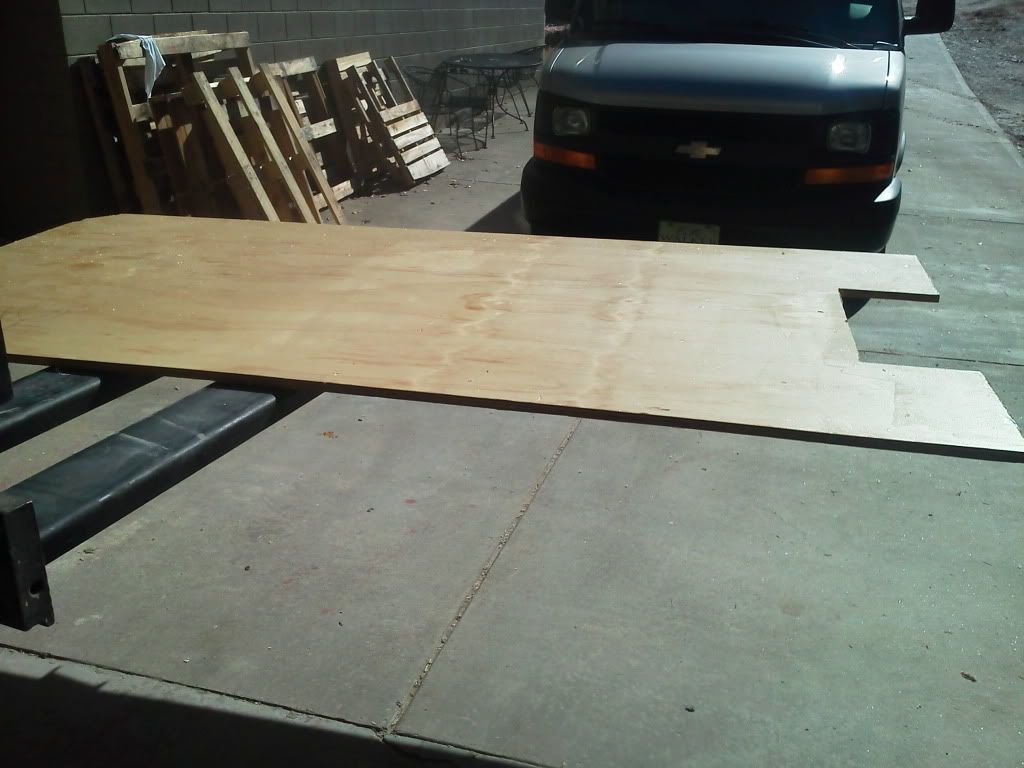

Well I got to do the resin today and fixed the slices that I put in the hull.
Here is the deck
front part of the bow
and the transom
and this is the slices that I fixed
The first quart I mixed up went well clumped up at the end so I so I used less hardener on the 2nd batch but with cooling temp it was slow to dry hope that doesn't mess me up

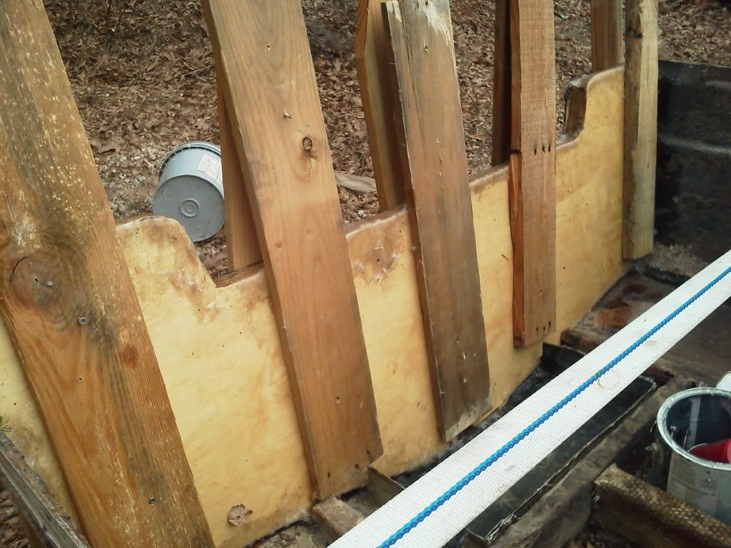

Re: Sportcraft tri-hull rebuild
Well glassed the transom in today and next week I guess it will be the foam and the deck (well I can dream) here is a couple of picks
/QUOTE]
Eaglejim, are you sure you made those slices? My boat has holes in the exact same two spots. On the port side there was a factory void in the fiberglass so there was only gelcoat in that spot and it broke through at some point. The starboard side has been repaired at some point with fiberglass for a hole or cut there.
eaglejim
Feb 2, 2008
1,006
/QUOTE]
Oh yeah it was all me and that little tool apparently not to thick where the hulls meet in the middle
