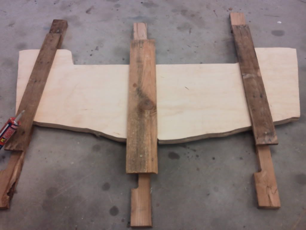

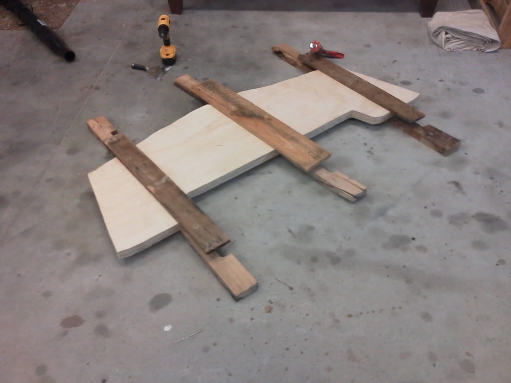

Re: Sportcraft tri-hull rebuild
Laminated the two pieces of the transom together
All screwed together
Takes 72 hours for the PL to fully cure. Did you use a 1/4" trowel to spread it evenly? If it's been less than 2 hours I'd go ahead and use Deck Screws and place em about ever 6". Don't want any air pockets on the interior of the lam. You can remove the screws after it fully cures in 3 or 4 days. When you install it in the boat the resin will fill the screw holes so no problem there.
Well did it a little different,I did trowel it on and I did use deck screws except they are on the wood pieces acting like a vise and I am going to let it set for 3 days. I guess 2 out of 3 ain't bad (I think I can make a song out of that). I will need some input on fiberglass next so if you can give me a little notice so I know what to pick up and be able to do it right it will be appreciated.You guys make me look like I know what I am doing, Thanks again Jim
