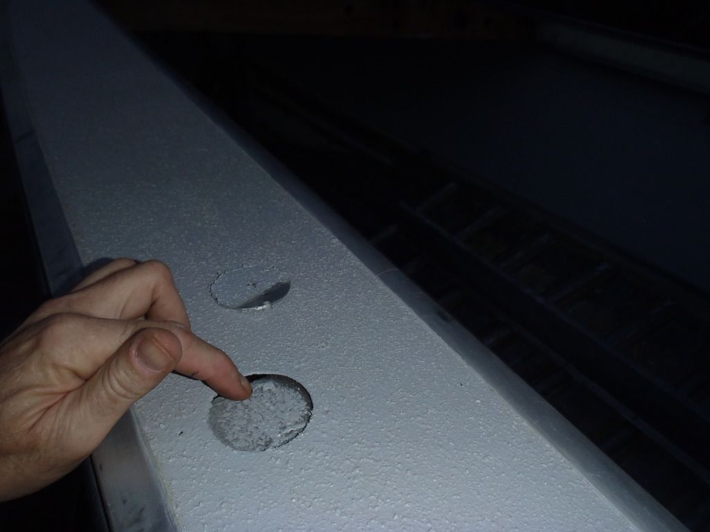

one of the cutouts came in useful. when i JB'd the patches to the underside of the gunwales, the one big one where a rod holder used to be sagged a little bit....should have clamped or wedged it.
WHY I SAVE SCRAPS:
perfect fit!

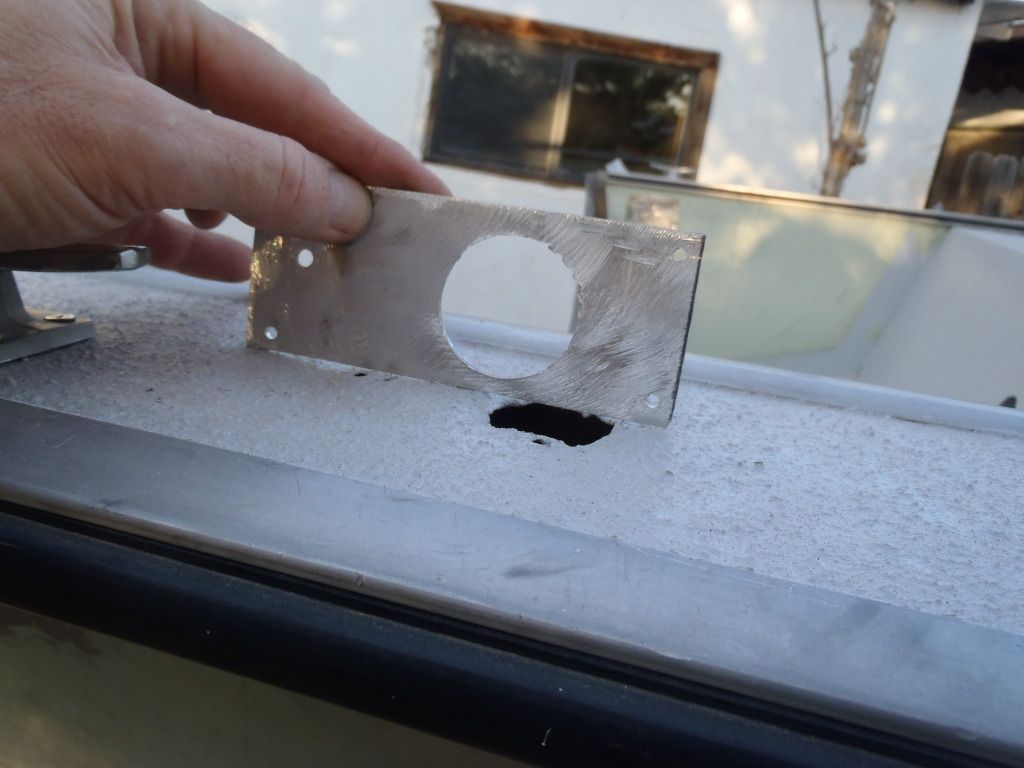

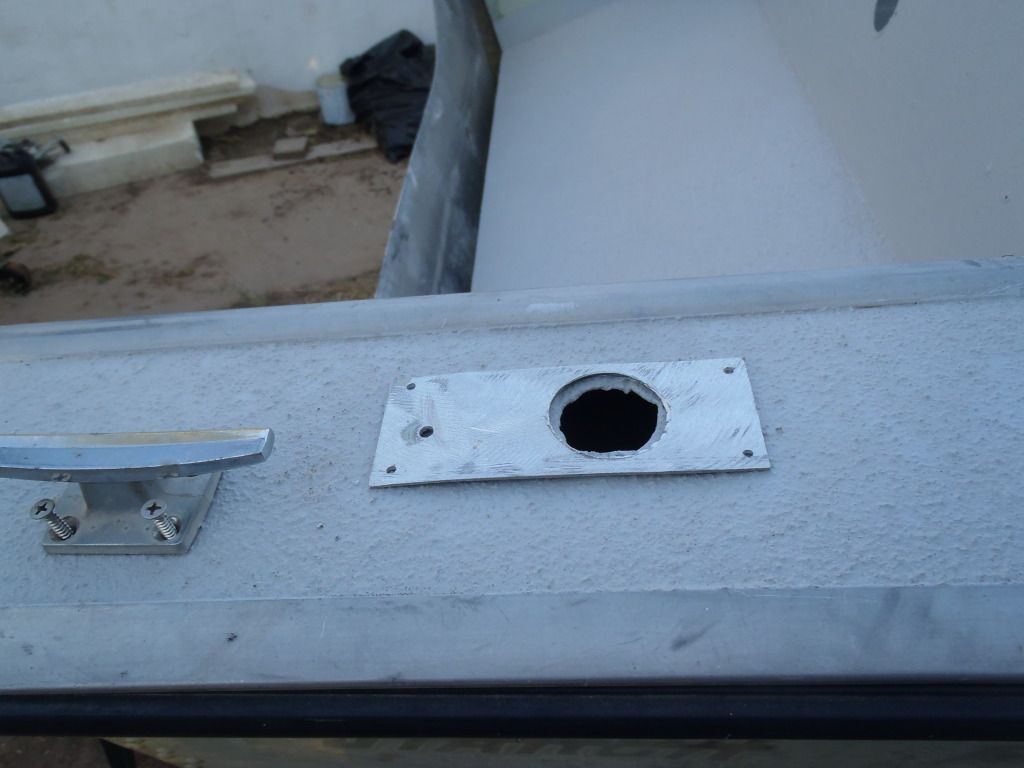

weight of the old Jetson light had buggered up the gunwale top pretty well, and i wasn't able to beat it back into shape from below....just lacerated hand/wrist every time i tried. hopefully you can see the distortion against the straight edge:
so i cut a plate to fit over the bad area from an old hunk of Lone Star....it will be screwed through the gunwale to the reinf block below and then covered with durabak when i hit the touch-up round:

I like the teak rod storage mounts.
It's a nice touch.
That plate looks like a good idea for the stern light.

the plate is pretty necessary...the alum underneath is so warped, i doubt i could put enough 5200 into there to seal it fully
