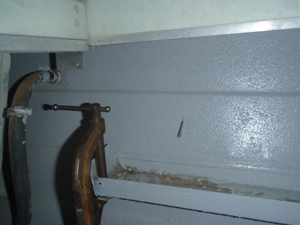

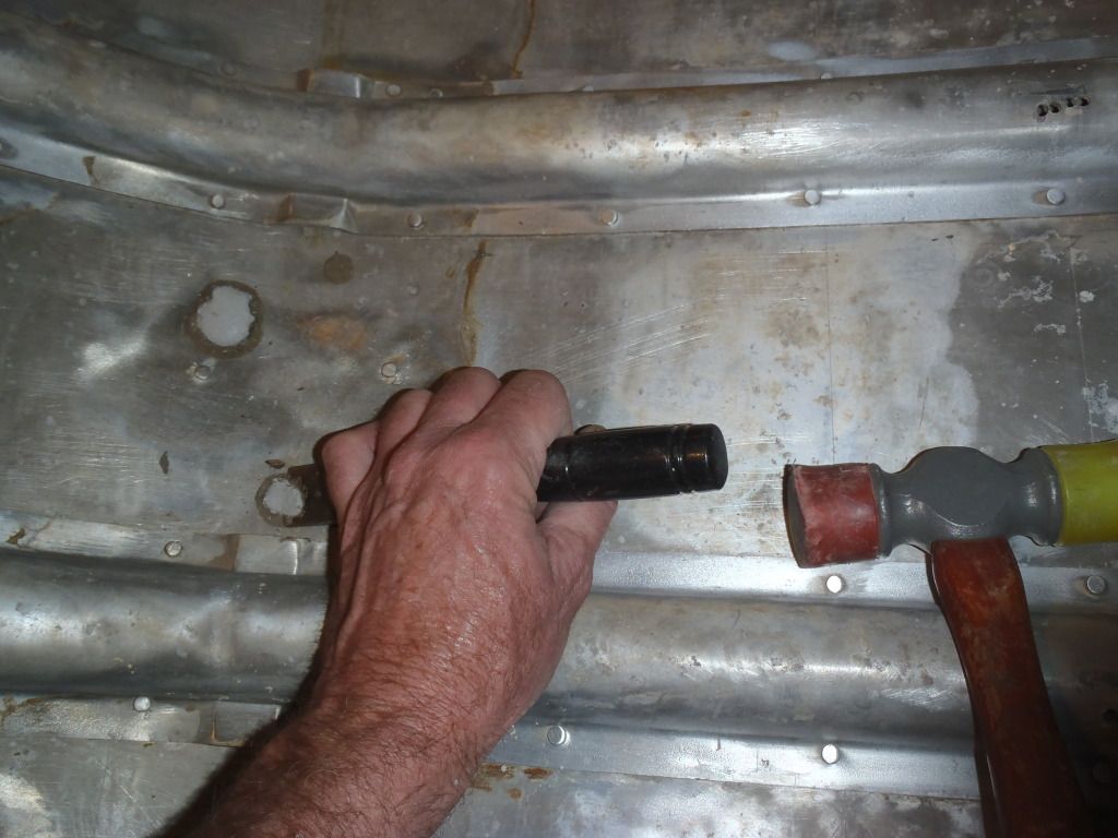

a little vignette on the adhesion of the durabak: remember that 1" or so of dirt in the bottom of bilge, that i washed out from under ribs? hadn't yet removed it when i rolled out the Durabak. in course of rolling, it's easy to have globs of the stuff going everywhere and i dropped one on the dirt pile. it saturated through the dirt and is stuck to the floor well enough that i'm going to have to chisel it off with a putty knife and mallet...... :eek: i'm now thinking about using the remainder to do top of my truck cab and camper shell since paint gets abraded off by portabote and plywood etc being carried up there......my auto painter friend would be appalled:facepalm:

thinking i'm going to save the leftover Durabak for something, maybe top of my truck cab and camper shell. i'm just wondering if i NEED to paint the bilge to protect aluminum for saltwater use. anyone got any thoughts?

that's what i wanted to hear. i'm tired of surface prep and still have to finish the gluvit. based on what i've seen with the Durabak, you could probably just slather it over the whole hull interior and get the same effect as gluvit. next boat....

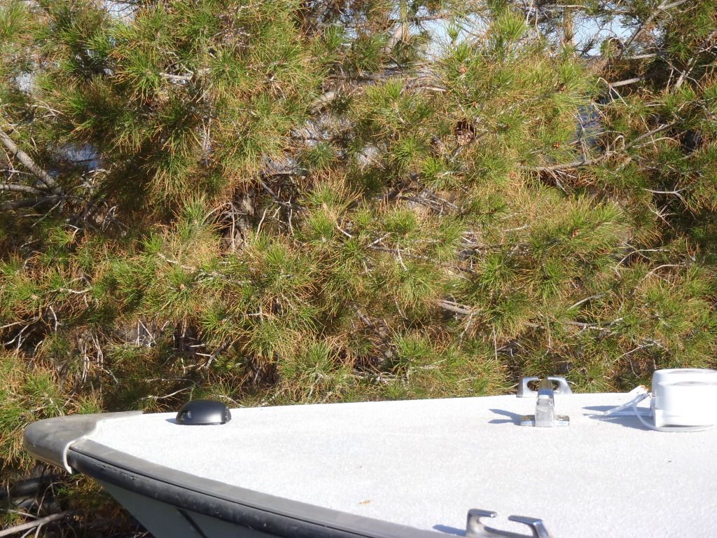

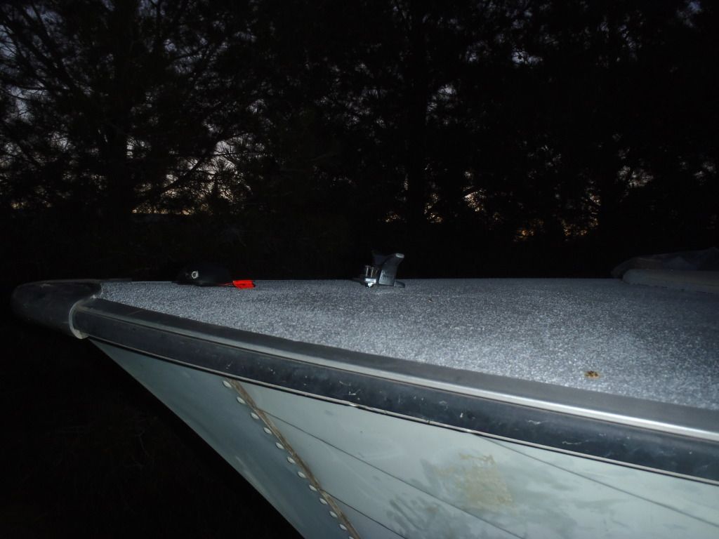

a few pics from this week:
the new LED running light test fitted on bow
the new horns test fitted....these are Ongaros and are both full-stainless and powder coated plus i like the low profile

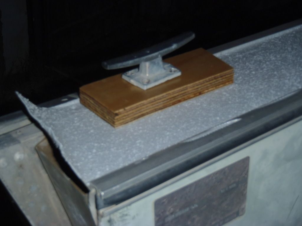

rough fitting the reinf block for stern cleat (yes, it will go under the gunwale):

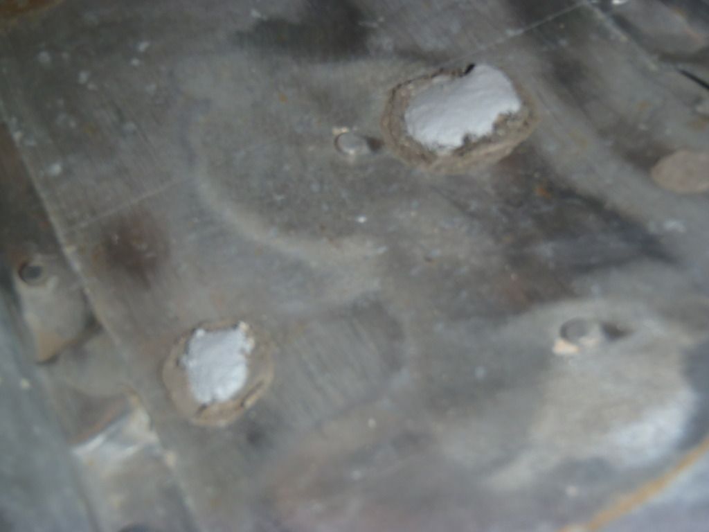

remember those globs of spilled durabak that stuck to the floor through 1" of dirt?

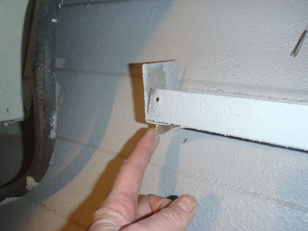

why you shouldn't let fools with angle grinders near your boat
a couple more in next post. not much progress to speak of, more of that brainstorming....

trying to fix the angle grinder damage

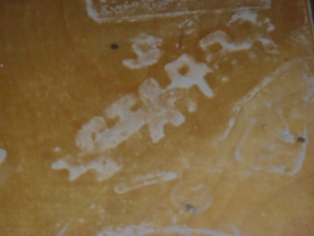

brainstorming session/wallowin in the MBS
is this like those images of Vishnu that you read about appearing on chapatis?

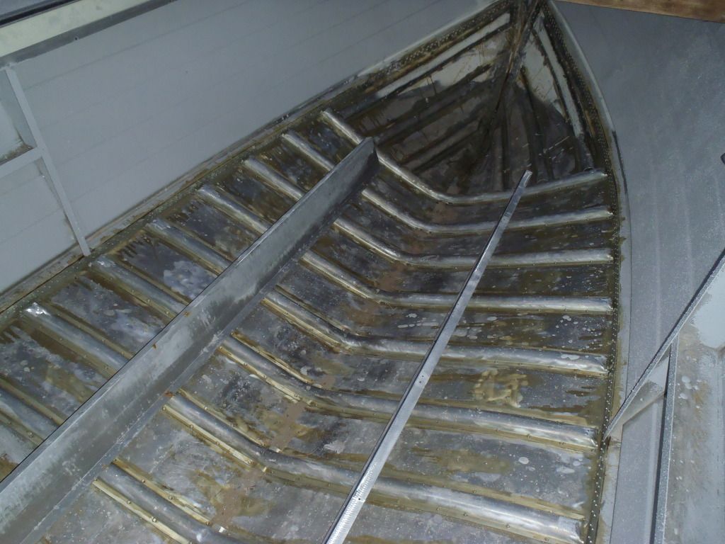

had another weekend off from the cabin so i got after the boat again. it's frustrating sometimes to look at the pix and think how little it looks like i got done compared to how sore i feel.

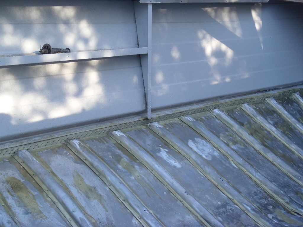

finished the bottom rivet prep and got the Glouvit applied Sat morning. i'd already done the major prep with 6" wheel on the angle girinder so this just involved using the 1/2" drill and smaller wire wheels but it still left my hands and wrists really sore. pretty impressed with the Gluvit....having used both it and the competing product Coat-it, i think the Gluvit is likely to do a much better job soaking in around tiny gaps. missed a few spots here and there as i was slinging like mad to get it on before it hardened up in the can.....if pot life is 90 min @72 deg F, wonder what it is at 95 deg when being applied on shiny bare alum that's 130+. degrees. but i figure it really should flow into gaps when it's that thin from being hot. i just went over the missed spots with some plain epoxy resin the next time i mixed up a batch.
rest of weekend was mostly devoted to reassembly/reinstall of topside bits, slathering on yet more epoxy, and test fitting the stringers.
