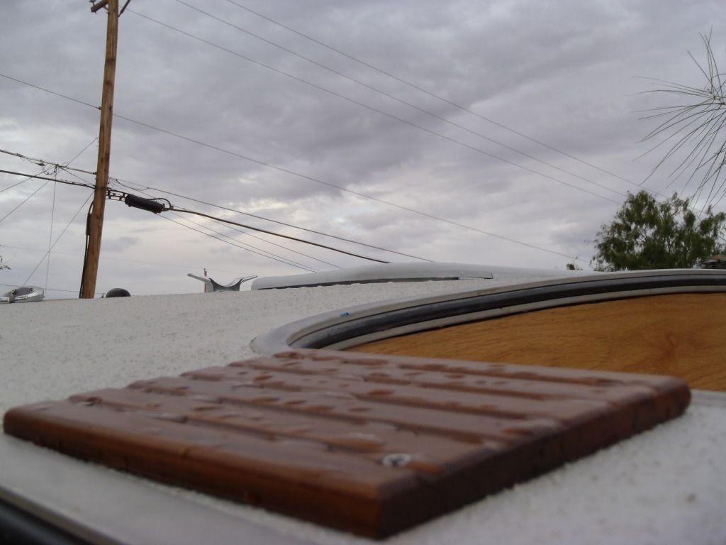

Artsy shot of the step pads and rainy sky

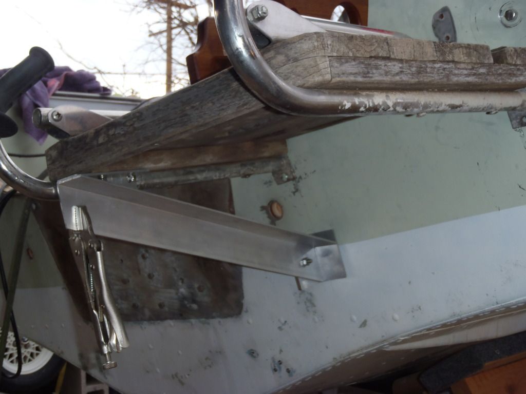

the transom brace for swim step, cut and clamped in place for drilling

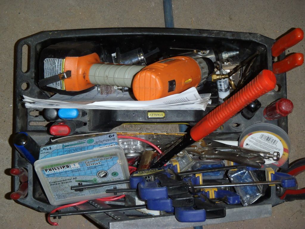

time to clean out the tool tub?
