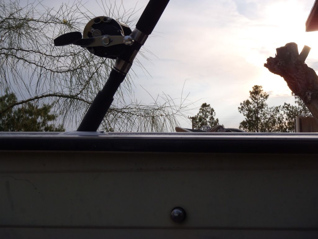

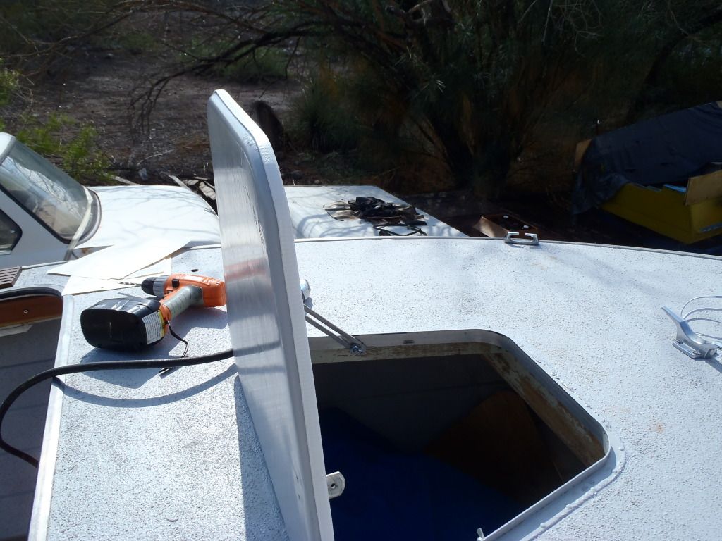

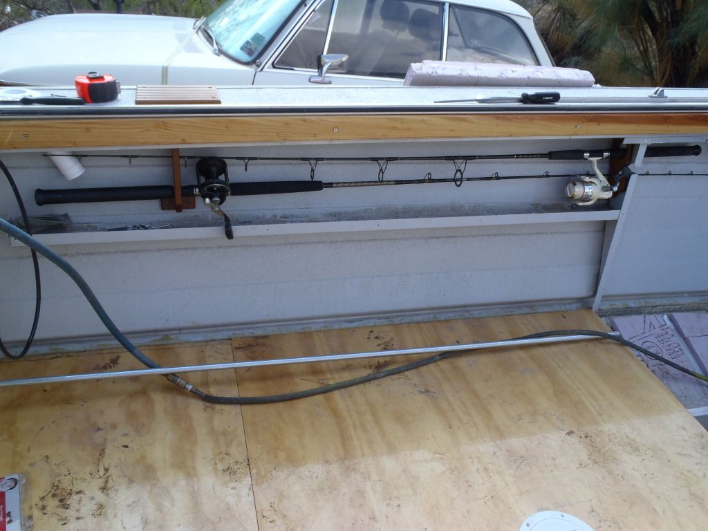

got the teak rod racks installed....not perfect, as i'll have some interference with vertical rod holders with longer rods, but it's done, for better or worse:
new trim edging on the bow hatch:
now THERE'S some workmanship for ya.....oops

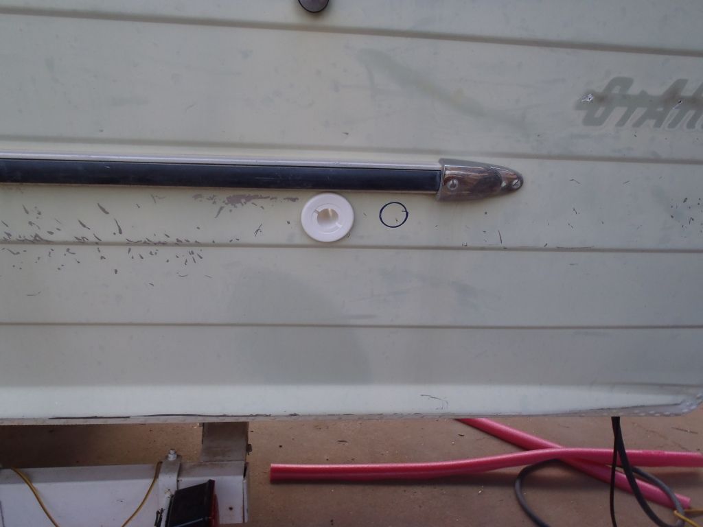

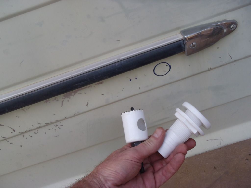

steeling self to cut BFHole in side of boat for big bilge pump outlet
incidentally, the interior bore of that outlet for 1 1/8/1 1/4" hose is exactly the same diameter as the outlet for 7/8" hose that was already on the other side of boat.....have to wonder about what my killer 1500gph bilge pump will put out through that
done:

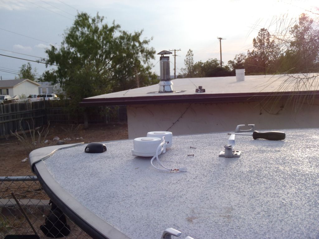

seeking input on location for horn....decided after i drilled the mounting holes near bow that it might look/work better just aft of the hatch. anyone have any thoughts?

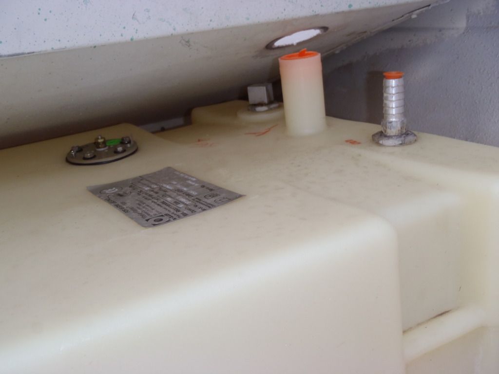

test fit the gas tank, and what i thought was an exact replacement apparently will have some minor clearance issues...no room for filler hose once i get the filler installed. i plan to just cut the plastic tank neck down and shim the filler up, unless anyone has a better idea.

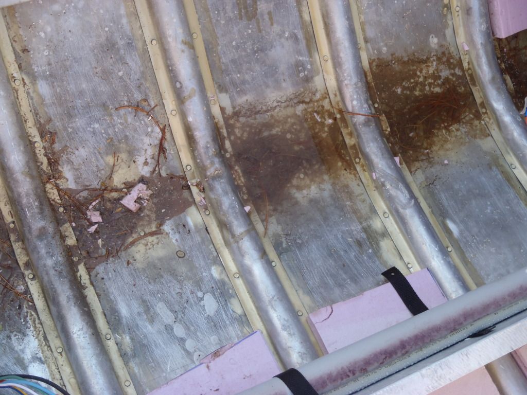

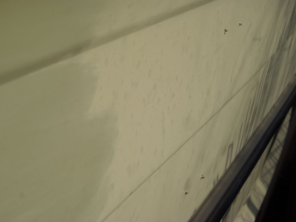

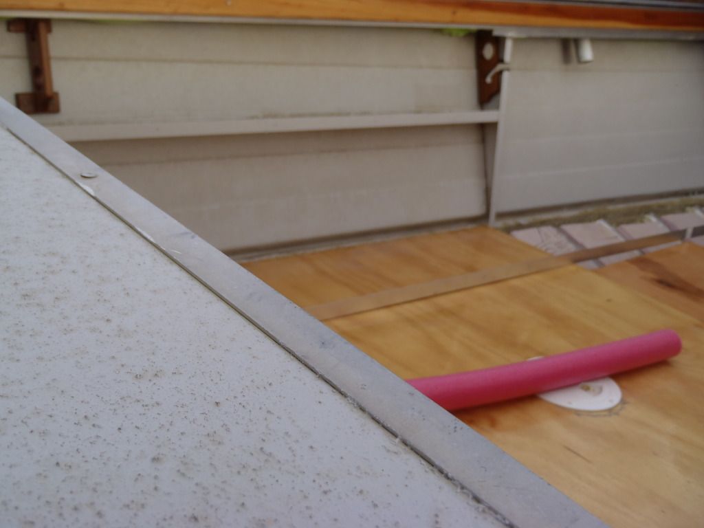

a little photographic parable about how fast crud builds up in bottom of boat and how easily the limber holes clog up:
that is just dust from airborne dust storms and what little bit of dirt i've tracked in since last vacuuming out....but note how it is enough to clog the limber hole

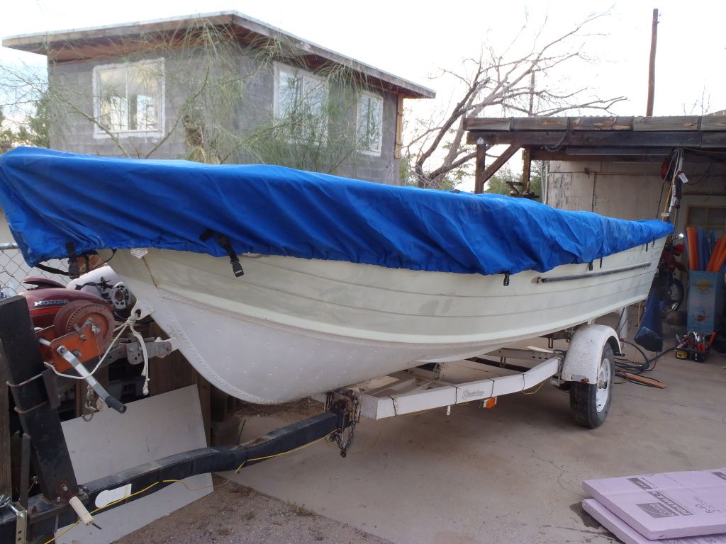

vroom vrrom zzzzzzzzzzzzzzzzzzzzzzzzzzzzzzzzzz!!!!!!!!! dreaming of screaming.............drags
DEVIL WITH A BLUE DRESS BLUE DRESS DEVIL WITH A BLUE DRESS ON
(THE SNAZZY NEW BOAT COVER----AFRAID TO INSTALL IT TIL I GET THE TABS OVER TRANSOM CORNERS BENT BACK DOWN SO THEY DON'T SHRED IT IN WIND)

Looks good B2 --- do I see a old Lancia in the background??? Trying to figure out what kind of car that is... :)

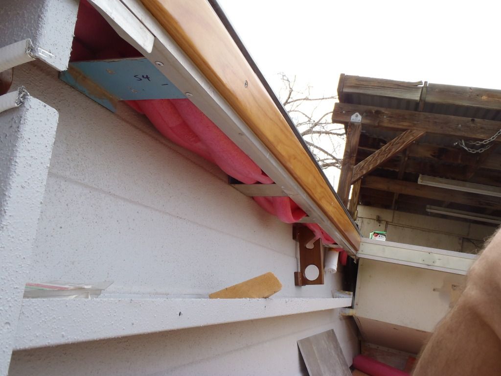

i sort of punted on idea of boxing in gunwales....more work than i want to do right now and easy to add later. this would have been the first step of that job, so i can still finish it if i want.

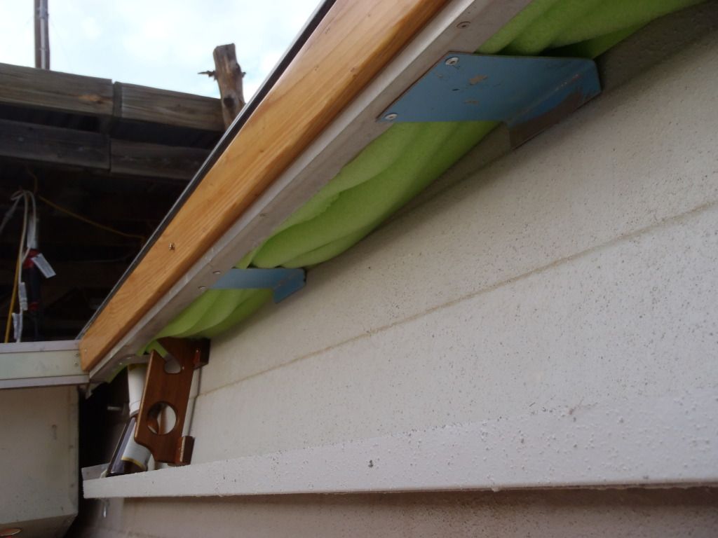

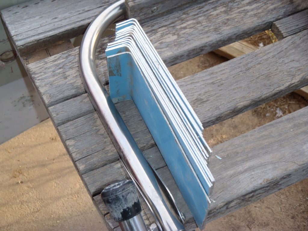

the gunwale-to-hull ties cut:
what they look like riveted in place, after adding the linguini (quartered noodles)....green for port and red for starboard

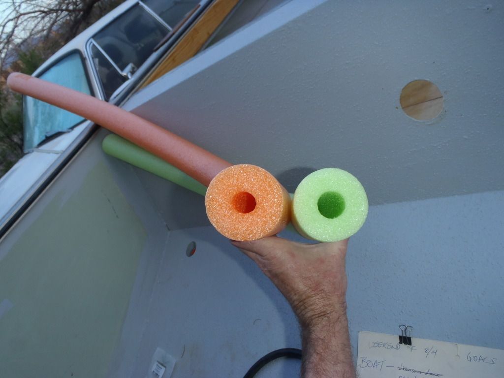

i was only able to get maybe 15 full noodles into the gunwales....am i doing something wrong?
finally, i learned something veeery interesting about noodles. there are noodles and there are noodles. the Canadian made ones i got at Ace hardware for $1.29 are 2 1/2" diameter with a 5/8" center hole. the American made ones i got at the dollar store for $1 are 2 1/4" diameter with a 7/8" center hole. guess which ones give more flotation per foot? i'm too lazy to work out the difference in foam volume, but be aware that not all noodles are created equal. you can see the difference here btween the Canuck ones (orange) and the US ones (green).

B2 - Can't remember what you are doing for seats --- would you consider putting the tank under a front seat or putting a bench at the back to bring the tank more forward to give you room? Just a thought?
I think the horn is fine. Size and location. It's out of the way of the hatch... and besides there is an old saying about the size of one's horn being inversely proportional to ones.... welll I'll leave it there! :)

i need to use this tank in stern cuz i have another one that's going into bow once i get floors in....i want at least 35 gallons onboard fuel + kicker tank. i am going to have to build a box for a seat riser, whatever seat i use, to see over my too-tall console. decided this weekend against cutting console down. i'll have get console in first to get a good idea where to go on that though. i may build it tall enough to put another 12 or so gal tank under it. i toy with idea of a leaning post but most are too wide for this skinny hull.

Thats right... I remember now that you have that great center console setup! My brains gone to vacation mush! You'll need to attach a 90 elbow with a 2 inch or less expansion joint to the fit under the splash well. Even that'll be tight! I used a 2 or 3" piece of fuel hose and a solid elbow that came with the tank to make the tight turn. So far it's worked well. Food for thought perhaps!

i may have to do something similar with my tank using a 90 deg elbow....but i'm afraid to use one with too sharp a bend for fear of gas splashing back when it's asked to make the sharp turn.....EMT bent on a hickey would give the sort of rounded bend i'm ideally looking for.

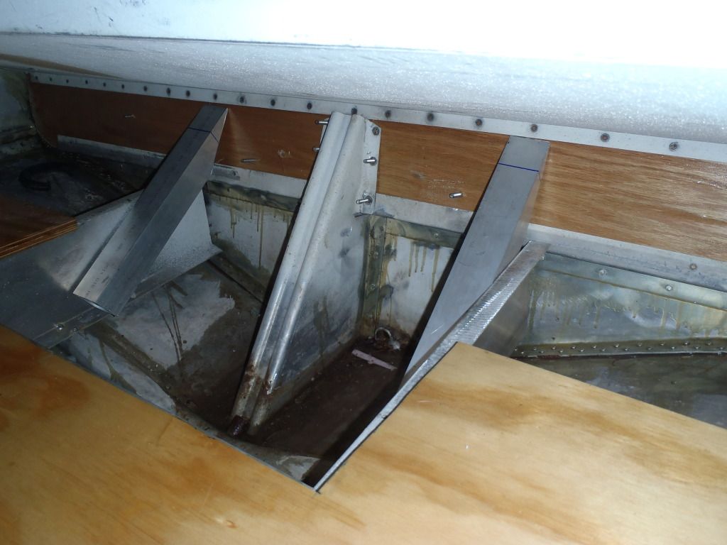

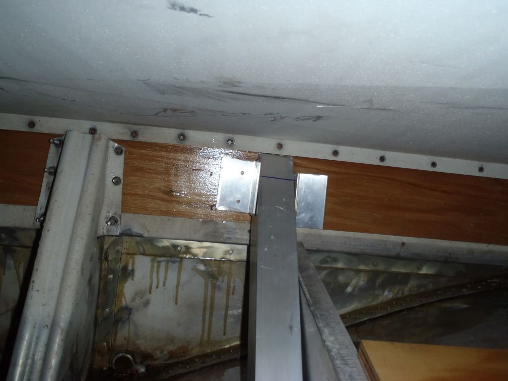

here are a couple of boat pix til i get more done....test fitting the square tube for supplemental knee braces. tubing is 2x2 with .125" wall and angle braces on transom will be 2x2x.125 L-channel. not sure how i got the angle of the cut so far off where it should have been but i can recut it and no one will see.

Those new braces should keep the Chrysler in check, B2. Measure once, cut twice is my method too. Not preferred, but I sure seem to do it a lot. :facepalm:
