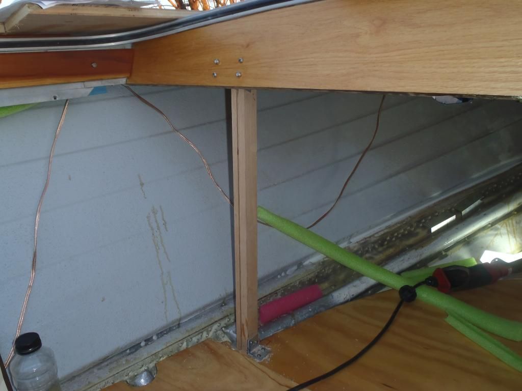

Hi all. Not much progress last few days; mostly working on trim for console (protecting the end grain of the plywood is especially important when your plywood isn’t waterproof....).

looking in through the hatch at the reinforcement, and the edge trim along front face of console
