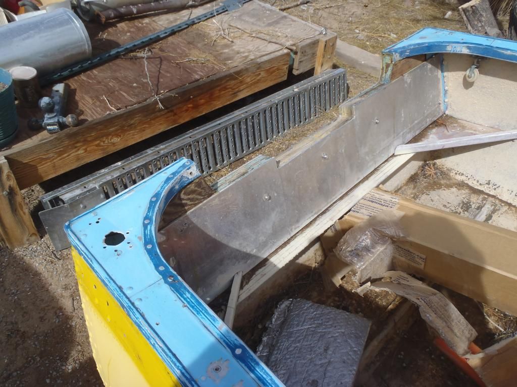

since that i've heard that the Mob are the Ultimate Missourians and won't believe anything without pix, i hereby present verification that the lone star is alive and well, if not too pretty. will somone teach that fool how to restore an aluminum boat? like the part about you only need to put the Coat-it on the INside of the hull....?? the Aesthetic Police need to send Vito to break that guy's kneecaps.
[/IMG]
you can see that i at least had the decency to pull off the wood superstructure and quit trying to make a flat bottom boat fit for offshore use, now that i have a Real Boat :cool:
boat does show some pretty heroic efforts to avoid having to bend up the aluminum and replace the transom....1/4" alum plate across full width of transom, inside and out.
Would it be less-invasive to remove the last 12" of gunwale cap when popping-out the old transom?

bluefin, that's a great idea, thanks. i'll try that when i get there. for right now, gonna just get this one legal and use it as big tiller steer boat with the 10hp honda. lakes in NM aren't that big and the alum plate would suppport the Honda even with no wood in the middle. oh, and i also need to replace that big section of hull on the other side of the boat where i've been cutting out aluminum sections to use on the holiday......;)
