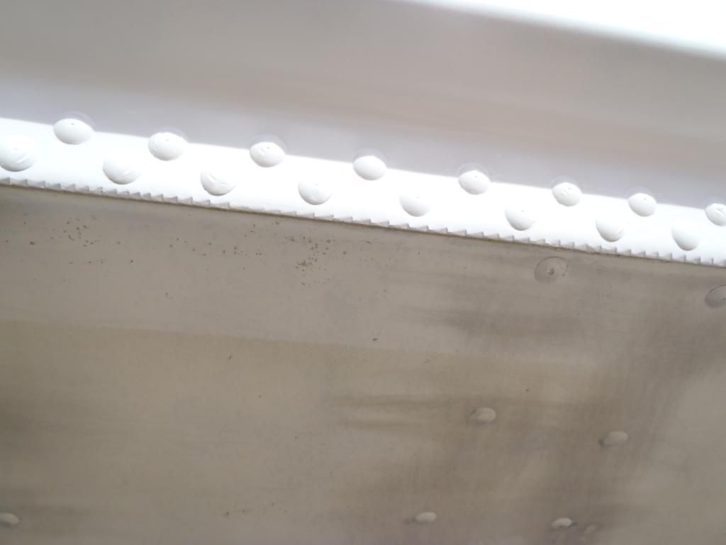

Skipped the 220 in jitterbug step for the starboard side....just wirebrushed around the rivets and scrubbed with scotchbrite and soap. incidentally, i found that these little brushes with super fine stainless wire work GREAt for cleaning around rivets, and that it seems to work better if you leave all 3 brushes in the package.
[/URL][/IMG]
[/URL][/IMG]
wasn’t entirely happy with result.
[/URL][/IMG]
[/URL][/IMG]
[/URL][/IMG]
I can live with it. Main concern is getting the shark mouth decal to lay flat and adhere right. if i need to, i'll go back over the area where it will fit, and sand and re-do.
