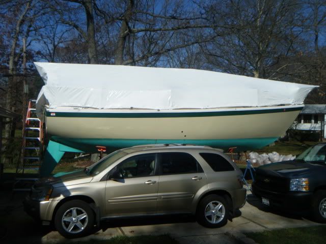

This is the boat I did with Interlux Perfection- a '74 or so Cape Dory Typhoon-
I liked it, it went on well (I rolled and tipped, but much of it was non-skid), and lasted. I can't tell you what the current condition is, As I sold the boat a while ago. The biggest drawback in my book is the lack of color options.
