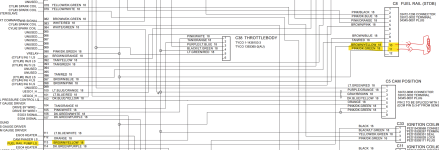

Thanks for your research and input!!
I could only find this (below) that shows the signal going to the starboard side fuel rail. I traced it out and it does. But the diagram doesn't show the red line I drew which are after that connector and plug into the HPFP. One conductor is 12VDC the other is from the ECM and is the one I put the oscilloscope on to read the PWM signal to the pump. My best guess, but I'm not sure, this signal is derived from the engine sensors (with some math) and used to supply pressure to the injectors based on the RPM vs Pressure chart. Effectively changing the displacement as needed on the CAM driven HPFP. Again, not sure.
Wondering about the internal relief valve. You could be on to something there. Is there a way to tell if the relief valve is opening? I can look and see if I'm getting a pressure bump on the supply side. Agreed, failing on 2 new HPFP's is hard to believe, but I'm desperate, I'll check it.
I will definitely try your suggestions about reading rpm vs pressure and circle back here with the results.

Biz603
Sep 14, 2025
46
Wondering about the internal relief valve. You could be on to something there. It seems to be acting like a relief valve. It drops the pressure, then keeps the pressure dropped until the RPMs come down and the valve closes again. And because I'm getting no codes, at this point. Is there a way to tell if the relief valve is opening? Maybe I can look for a pressure bump on the supply side. Agreed, failing on 2 new HPFP's is hard to believe, but I'm desperate, I'll check it.
I will definitely try your suggestions about reading rpm vs pressure. I'll circle back here with all the results.
Thanks again!!

I'm trying to invalidate my theory that the HPFP displacement is fixed. I'm mostly relying on VP's part diagrams per the attached link. I'm using my 2022 250 hp G5 engine s/n which I believe is identical to yours sans ECM.
The HPFP shown doesn't show a harness connection. But both port and starboard rails have a harness connection that I believe feeds the ECM PWM signal to the injectors.
Did your HPFPs have a harness connector? If not you may have been measuring the PWM signal for the starboard injector control harness shown.
Earlier this summer I was working with VP Sensei @muc on a full throttle range performance issue. Diacom showed injector pulse widths always below 5 ms. ...I'm thinking full power demand should be at 16-18 ms.
So unless the HPFP has a connector I'm sticking with my theory about fixed displacement/cam stroke.

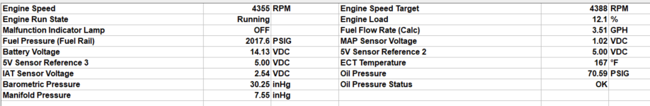

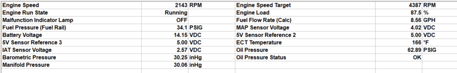

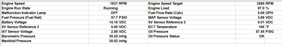

Biz603
Sep 14, 2025
46
Ok. Ramped up to steady for 20 seconds here (below):1758376540491.png
Then, one second later:
One more second:
One more second:
You can see I was throttling back here because it was dying. It then went to idle speed.
I can do this over and over. Always dies around 4300 rpm.
Tried throttling up slow, same issue.
Tried throttling up fast, it will get to 5800 rpm and die out 1-2 seconds later.
You maybe pulling back on the lever, but from these "snapshots" The ECM seems to be adding air and fuel.
If you look at manifold pressure, it's going up in chart 2 and has reached WOT in charts 3+4. Guessing the ECM is trying to add more air by opening the butterfly in the throttle body. If you look at TCP and TPS actual and commanded you might see more.
Now look at calculated fuel flow, It looks like the ECM is adding more and more fuel in charts 2+3 and even though it drops a bit in chart 4 it's still calling for more fuel then chart 1. If you look at injector pulse width you might see.
Hard to tell much with so little data. But (just a wild guess at this point) it looks a lot like there is air getting into the fuel system before the high pressure pump.
If you haven't yet, I would highly recommend that you take a look at cranking voltage during a Diacom recording session. Low voltage during cranking can cause some very weird things to happen in the ECM.
When you take your next data run also graph injector pulse with along with engine rpm and rail fuel pressure. ...@muc knows Diacom like the back of his hand, so he may be able to give you better advice.
I'm pretty sure the HPFP is PWM with a fuel pump solenoid valve. The wires for it are in the harness and the diagram shows a HS and LS at the ECM. This thread has been a learning experience for me. Had no idea there was a pressure relief in the high pressure side, but it makes sense because this is a positive displacement liquid pump. It could blow itself up without relief. With the OPs symptoms it would sure be tops on the list, But 3 of them?
My manual has the fuel feed pump pressures showing.
