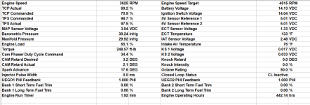

You maybe pulling back on the lever, but from these "snapshots" The ECM seems to be adding air and fuel.
If you look at manifold pressure, it's going up in chart 2 and has reached WOT in charts 3+4. Guessing the ECM is trying to add more air by opening the butterfly in the throttle body. If you look at TCP and TPS actual and commanded you might see more.
Now look at calculated fuel flow, It looks like the ECM is adding more and more fuel in charts 2+3 and even though it drops a bit in chart 4 it's still calling for more fuel then chart 1. If you look at injector pulse width you might see.
Hard to tell much with so little data. But (just a wild guess at this point) it looks a lot like there is air getting into the fuel system before the high pressure pump.
If you haven't yet, I would highly recommend that you take a look at cranking voltage during a Diacom recording session. Low voltage during cranking can cause some very weird things to happen in the ECM.
I have also found that once the engine gets into Closed Loop "CL+Adapt" take a look at how the fuel trims change thru out the RPMs and check the misfire counters both historic and real time.

Ok Muc, I have some test results for you.
Watching the voltage at startup. The battery is at 12.1VDC before cranking.
During cranking it drops to 9.4 for a fraction of a second then comes back up to 14.2 when the alternator kicks in and the engine starts, about 2 seconds later.
In terms of misfires. Didn't see any recorded. Here's a screen shot after ramping up to 5400 (surprised) just after the engine quit.
As for fuel trims, they hover around +/-4. Never above 9. Always seem to hunt back to around zero in with a steady throttle position.
You were right about the The TCP and TPS actual and commanded numbers are tight throughout the RPM range. Until the RPM start to drop, because of this issue, then the TPS commanded and actual go to near 100%. TCP stays where it is.
You can see it here, taken just after failure:
For what it's worth, the Engine Load Data will jump to 86% during the failure. I believe this number is calculated off the throttle position, MAP, and other sensors. Since it's calling for more air and fuel it seems to make sense it's going up. Again, sounds like the butterfly valve is opening all the way during failure.
Regarding the fuel pressures / flow. I don't know of a good way to measure the flows, but I can tell you stage 1 sits around 20psi. Stage 2 stays around 70-75 psi. Both never really move or drop. At any RPM, during a failure, or after a failure.
What do you think?

Might be better if you posted the .rec files. the two you just posted are just a snapshot of a moment in time. I can't see much in them.
The first chart of the misfires shows nothing because misfire detection isn't on at this moment in time. Did you look in the system info tab? Scroll down to the bottom.
For the different features of this engine to work, certain parameters need to be met first. I don't have enough hands on time with these DI engines to know what those parameters are. This is why I recommend a long 20-30 minutes .rec file. spend about 5 minutes at 1500,2500,3500,4500 and WOT.
The second chart was done before the engine was up to full temp, this can skew any readings. But I do see injector on time at 0 ms. Wondering why that is? It might be good to do a .rec file while running the injector monitor.
Cranking voltage at the ECM of 9.6 is low. How many batteries, what MCA rating and how old are they? The last dealer I worked at refused to troubleshoot newer engines unless they had a correctly rated, less then 3 year old battery.
The air in the system is more a comment on my part. It just fits the symptom. I have not idea how it could actually happen with your system.
I don't know of any way to test the relief. The only way I can think of is to replace it, but You've already done that twice!
I don't know what to think at this point. Maybe some good .rec files would show something?
What do you think?
If it's air coming in the fuel line, wouldn't gas leak out those same holes while under pressure?
I wonder if there is a way to determine if the relief valve is opening up?
Thanks again for the continued support.

Your Diacom charts seem to point to a disconnect between TPC and TPS actual and commanded values. Your comment about the TB gasping at shut down caught my eye.
Take a look at your ECG diagnostics manual. I did a search for "body" and came to page 87 for a good description of throttle body operation and one related DTC. There are two others with their own DTC. Derate2 can occur with each.
You haven't reported any of these DTCs, but it may be a factor with your issue.

Still digesting what I've learned from you and @muc.
HPFP is PWM.
Earler this summer I was chasing a performance problem on my G5 250 hp engne. Muc suggested my low cranking voltage, similar to yours, could be messing with the ECM initialization. I replaced my four year old battery and saw some improvement.
Based on your new supply pump and HPFP pumps I think its safe to assume these are good. So it seems some other inputs or conditions are causing the ECM to derate.
I will replace the battery tomorrow and try it.
My page number is different but the description was there. It seems that the throttle body commanded position changes based on "Engine RPM, engine load via the MAP sensor" data.
So as this failure is happening, the RPMs are going down and the Engine Load is going up. All reasons to command the butterfly to open. Seems to make sense that what I hear.

Earlier I saw a bit of discussion about TCP TSP actual and commanded. Because trouble shooting odd issues like this usually requires understanding how and why the ECM makes the decisions it does, here is a little explanation. ETC = electronic throttle control, "fly by wire"
The Speed Based Throttle control system is used on all –J and later ETC engines not equipped with EVC-ec. In the speed based throttle system the TCP is still the driver’s “throttle request” and is still “hardwired” to the ECM. What’s different is that with this system the ECM sees the “TCP Actual %” and converts that percentage to a “target engine speed”. The ECM then controls the throttle blade to either increase or decrease engine speed until the engine speed (from the CKP sensor) indicates that it has reached the target. This occurs anytime the engine is not in idle mode. If the TCP is advanced to 100%, the target engine
speed is set to approximately 100 RPM higher than the maximum rated speed for that engine.
To the customer, this speed based system causes the engine to seem to operate differently than ETC engines in the past because the engine is governed to an engine speed not a lever or throttle blade position. As an example: the boat is cruising at 3000 rpm and the driver doesn’t move the helm lever but he starts turning to port. This will cause an increase in load on the engine. In the past and with lever based systems, the engine would start to slow down due to the increased load and the driver would have to add more throttle to maintain the same engine speed. With a speed based system as the driver makes the turn, he did not move the helm lever so the “target engine speed” did NOT change. So as he makes the turn, engine load increases, rpm starts to drop below the target so the ECM opens the throttle to try to maintain the target engine speed.
Likewise; if the boat is cruising and the drive is under-trimmed (bow down), as the driver trims the bow up, engine speed will NOT increase. Boat speed will increase. If the driver continues to trim the drive up, the load on the engine will decrease and the ECM will not need to open the throttle blade as far as it was to maintain the target engine speed. As the driver continues to over-trim the drive (bow up), the boat will also start to slow down but engine speed will not
change.
So the only thing the ECM is looking at (for this feature) is RPM.
