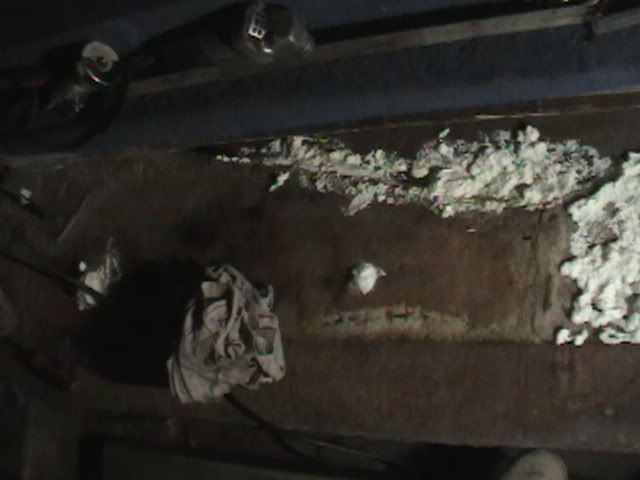

you can see in the following picture a larger gap where the foam simply never existed? regardless its a low spot that will put stress on the deck when stepped on, a $5 can of foam is worth correcting the "mass production" flaws.

Moving on...I ran the shop vac for a hot minute and decided to test run the big gap right stuff spray fun from THE Walmart. I decided to fill my core tests on the foam as well as fill the manufactures leveling gaps. check it out...
test cores...on the port rear
Test cores...on the starboard rear
I used the spray foam, it comes out pretty fast...and unpredictable however it does its job. Go ahead and be messy, because you will have to shave some down prior to fitting the deck. Wear gloves or simply dont spread it around with anything, it just makes things worst and your hands are screwed for a few days. No love from wifey with solid black man mitts....
