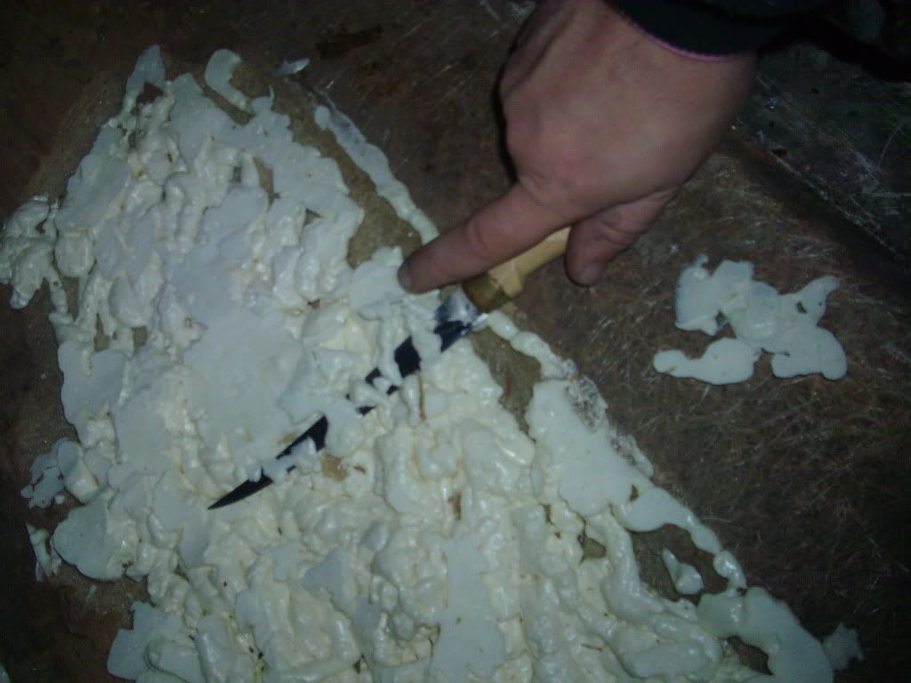

The portside deck is cut and fit under the tabs, here is a pic of how my "under tab" deck fitting is working out, its a lot of trouble and your deck has to be cut exact, measure 37 times and cut once.
Going to cut templates for the starboard side tomorrow, so i had to prepare my tabs and trim my foam so the deck can sit flush on the stringers. I use an old fillet knife to slice the foam down flush. Thought I would share...
flushing it up with the fillet knife...
finished and flushed...

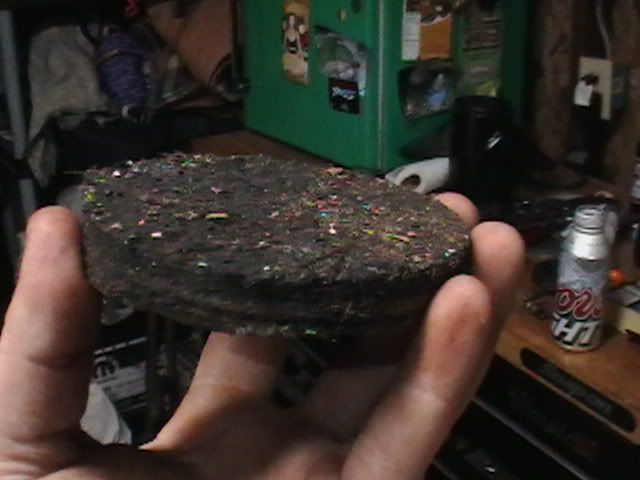

its in my american nature to investigate causes of failure and point out flaws of others lol, I spent the evening drinking beer (wife and kid were at disney princess on ice), burning rotten wood deck peices and cleaning up my mess around the boat and garage....i investigated a few peices of wood from the deck. its obviouse why this deck failed, however everyone needs something to look at instead of working right? enjoy...
someone had taken core samples of the deck at one point. however these sections had not been re-glassed, just recarpeted. This tells me that someone ripped out the carpet, inspected the deck, said its ok, than just carpeted back over...why does anybody have time to do it right the first time?
here is a random peice of wood and glass, there are two tack type nails thru the glass and wood. if you do this maybe some marine goop or butter, this was an invite of water into the deck.... can you spot the nail and where a nail had been?
i flip the glass over to see what had happened to the wood... a small tack nail had done this much damage....the wood is blackened and was certainly a source of premature rot..
