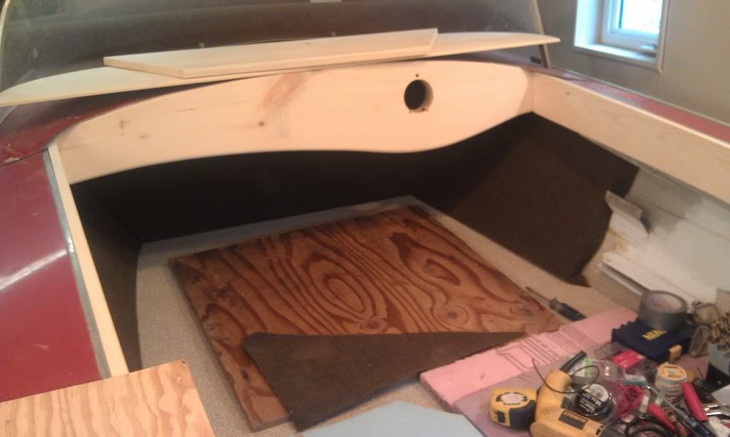

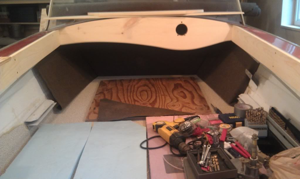

Well.... been busy.... so hopefully this is starting to look a little more like a finished boat interior...
Notice the hole for the steering and the carpeted side pieces and bulk head. All just set in there for the moment. I leave about 2+" extra carpet all around each board and then dry fit everything and wrap and staple and/or glue to the back when I get the seems as best as I can.
Little bit different angle.
Also got a chunk of wiring done. LED lights and bilge to still hook up.
One thing I haven't figured out is where the heckla to put the horn. I'll snap a photo tonight for reference... hopefully you guys may have some thoughts. I am scratching my head. Does it have to be externally attached?
Have a great day fella's.
Jim

To be MOST effective (heard) the horn probably ought to be mounted topside facing forward. My Jet's was mounted to the center support spar under the closed bow, fairly far forward towards the bow. This will make it seem LOUD in the boat though, and sound like it's sounding off in a tin can...............
Under the bow it can be a low cost horn & doesn't have to be a good looking chromed trumpet/horn....

agree 100% with JB, SUBJECT to the issue of horn taking salt water up the snoot. i ended up mounting mine on the side of center console for this reason, and to simplify wiring run.

Agreed! Under bow sounds :) good!

If possible you might try to aim the horn at the back of your carpeted bulkhead. Might tone it down just a touch for those in the boat.
I don't underestimate the fun of a stealth install & surprise horn test on the initial family outing :faint2: <<< again, untested hyothesis, and probably ill-advised...........
