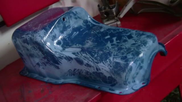

I was diggin' it till the valve cover. Not up to your usual standards. I think it would look cool if you just painted the whole valve cover that lighter shade. Glad you got your motor back.
I think your right. Gonna try that.
Azlo
Jun 21, 2009
706
Re: 1968 Holiday Restoration w/pics

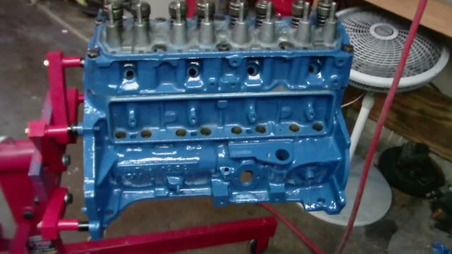

Tried it on the oil pan, but doesnt look good :mad: either. Gonna repaint one single color.
But some of Picassos stuff look like crap to me. I dont think i can pass it off as modern art.
I think I will stick to the basics.

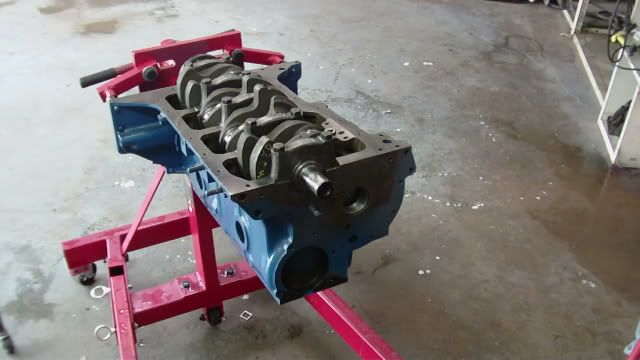

Thanks to I boats I have the torque specs from downloading the manual.
So cut some plastigauge for every main journal and torqued.
Well with in specs. Everysingle one of them.

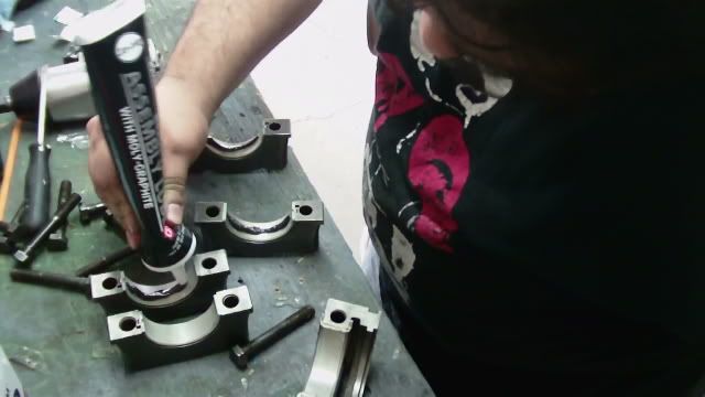

Now lubricate with engine assembly lube
Slid the crank .....
Azlo
Jun 21, 2009
706
Now all torqued & looking good, a little tight but with in specs.

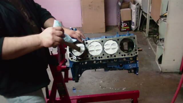

Now getting started on pistons. Using the old piston rings to clean the ring grooves.
Checked piston clearence and checked ring gap. All looking good.
Was gonna install the pistons and check other clearances but had visitors. So gonna wait, Monday.

Ok, had some time Monday. Heres what happened. Basically piston installation,
This is piston 2.
piston 3
piston 4
and finally piston 1
greasing the caps and torqued.

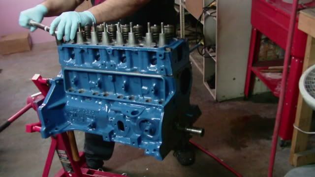

You know, after seing my engine going back together i dont think i can remeber getting so excited. You can almost hear me grunt like Tim Allen.
So started to clean the block surface, grinding any debri and paint.
Made sure the gasket fits and set it.
Set the head in place then torqued to 65lbs and then 93 lbs.
And here it is fellas. Head and block together again.
