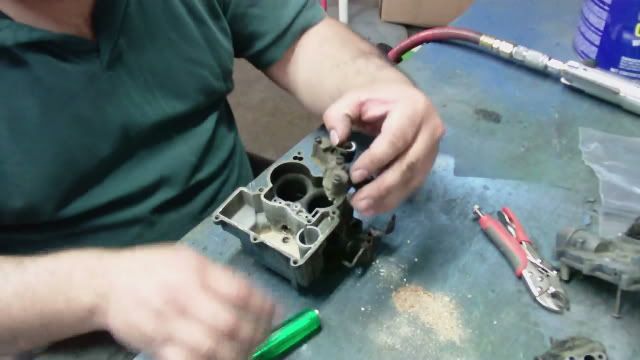

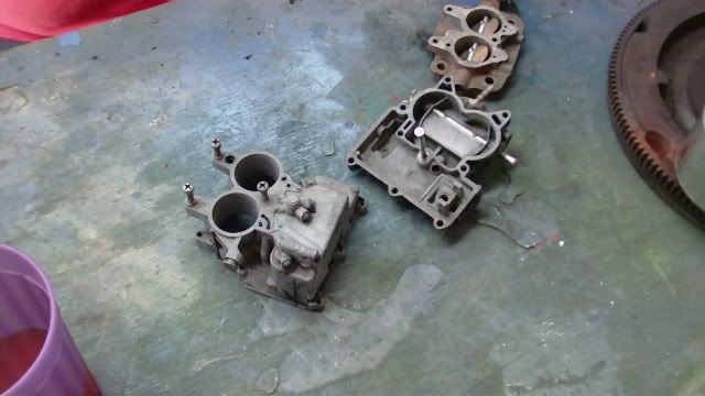

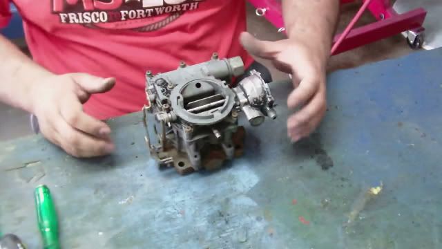

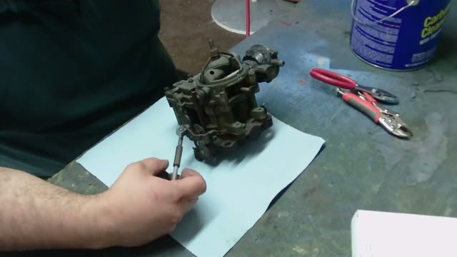

Ok, so now moving on to the carb.

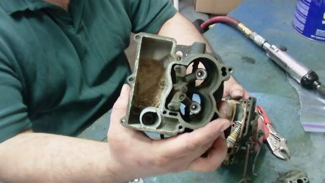

If the inside of the fuel pump was as it was I wonder how the car looks.
Nasty thats how. Look at all the dirt that came out.

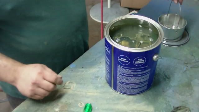

Seperating bottom from middle half.
Threw them in the carb clean tank and gonna let sit for a while.
Mean while this where Im at so far. Like the gold cheap color.
Man I am learning through trial and error I tell you.

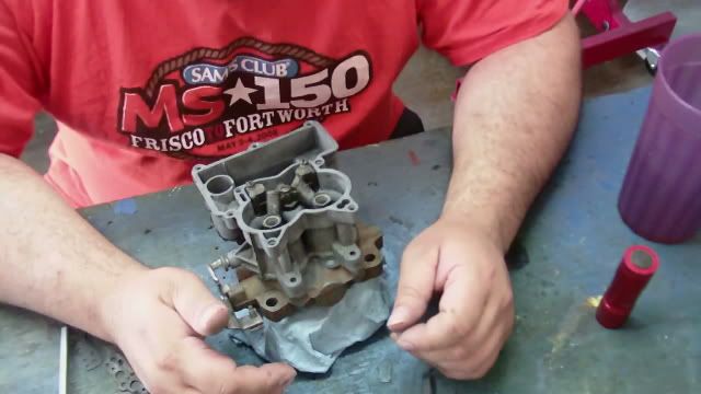

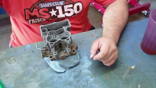

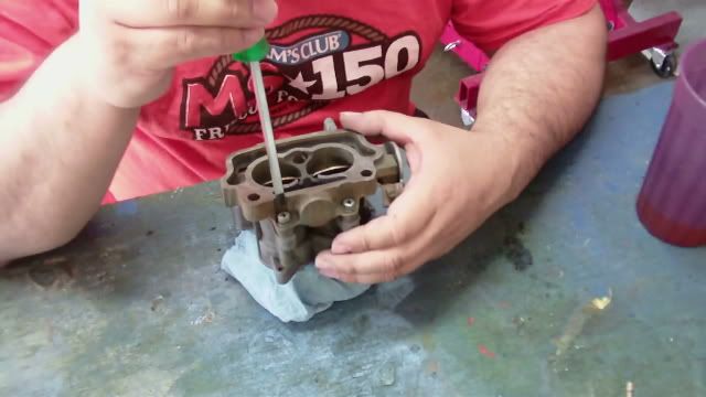

Ok, carburetor ready for assemby. Parts came pretty clean. After a week in the carb cleaner I would imagine so.
So I matched the gasket for the bottom base and the middle body got together.
Middle body looking really clean.
Installed the venturis, jets, balls, u name it.
Top section. This part was a litlle more tricky. Ihad to measure the float level, (of course) the float drop adn the plunger length.
SO here it is, a rebuilt 2gc rochester mercruiser carb.
I dont know wether to paint itor what.....but im just eager to turn this engine on. I think by sunday I will have it running.

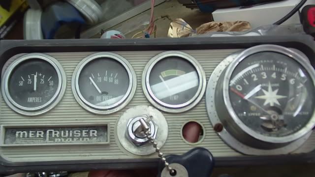

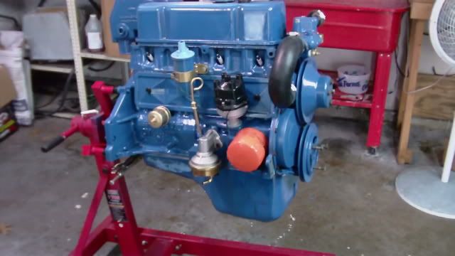

Man, your gonna hate me. I painted it gold. If my father would see this he would kick my a$#. He always told me never to use the golds, chromes and silver colors. But im in aexperimenting mood. Like I always said, the best learning is the hardway. Also I noticed the alternator was a regular automotive one. So i went ahead and got a 1 wire 105 amp marine alt. Now I noticed the same thing with the starter,,, it never ends.
Gonna wire the old gauges while I run the engine on the stand.

Vroom Vroom. LOL. Will your flywheel fit with the motor on the stand? I don't think I would run that motor on that stand. It will be much safer to go ahead and put it in the boat to test fire it.

I am gonna go out on a limb here and say that he will not start it on the stand as I don't think he can. Need the flywheel installed to start it and you cannot put the flywheel on the motor while it is on the stand. Just my .02 from what I was seeing.
Hench my original question.
