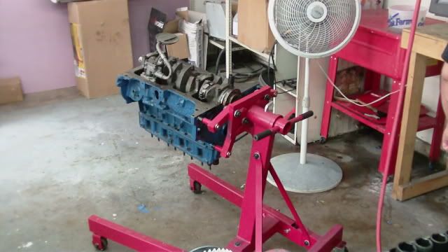

I was off work early today so I managed to install my rear seal. I forgot to install when i slid the crank in.
I also tried to install my freeze plugs but its just best to get the installer tool.
Before i put my funky oil pan i was also removing the nasty screen from the oil pump. just nasty. Gonna soak it over night.
STill waiting for my manifold and riser to arrive so I can paint & install. Will post soon. Right now Im off to Harbor Freighty.:)

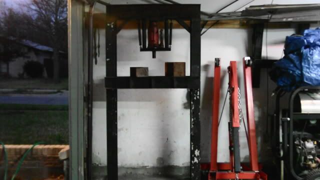

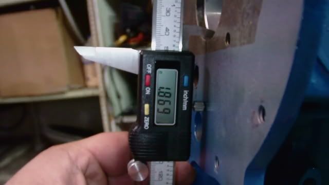

Thanks to Last Mohican my worries are no more,I went ahead and got a micrometer and measured my cam bearings. They measure at 1.869.

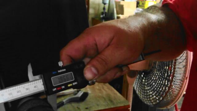

My cam measures 1.866.
SO it seems we will be ok, I think. I will double check the specs. Now all I need is to get by cam plate of the old cam & press it on the new cam. For that I would need to take it to the machine shop orrrr by me a shop press. So i look on harbor freight, northern tool and Craigslist. I do other work that i would benefit from the press so I would like to get a good one. But they are 400$ smackers for 30 ton. Ouch! Looked on craigslist and what do u know a used 30 ton press for $100. Really cool, except its like way out in the cocomo, an hour an a half to get to it an another 1.5 to get back. Well it was worth it. This thing is taller than I am.
Had a full day today time to relax and will try to get that cam plate off tomorrow to install on the new one. Thanks LM for the suggestion.

Good score on the press. I've been contemplating one myself. I just keep spending gas, time and money going to the machine shop. One of these days I'll realize the project I'm working on is not going to be the last press job I have to do. LOL.

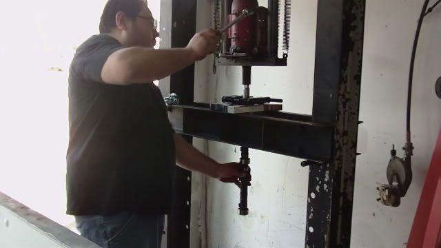

So now that i have a press, im gonna press my cam gear. But first I have to remove the cam holder off the old cam.
Now time to press the new cam gear & the cam holder on to the new cam. But have to be careful cause the cam holder, has to have a clearance of .001 to .005. SO i have to press SLOWLY.
Well i had to do it twice but finally i got around .002. Very easy though.

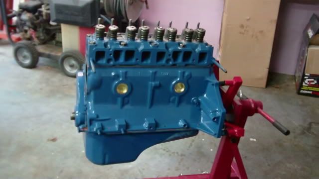

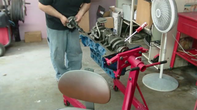

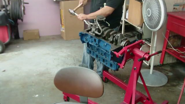

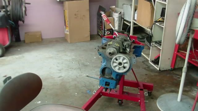

After getting the cam ready i installed the oil pump.
After installing the pump, i realised I oulcdnt install the cam with out installing the crank gear. SO crank gear in hand when it hit I dont have a socket big enough or deep enough to install this gear. So I used a tie rod fork. It worked!!
Lubed up the camshaft & slid it in.
Looking good man.

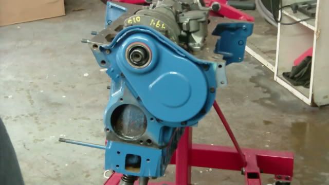

What next u say. Timing cover,, here we go.

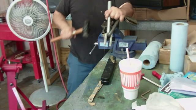

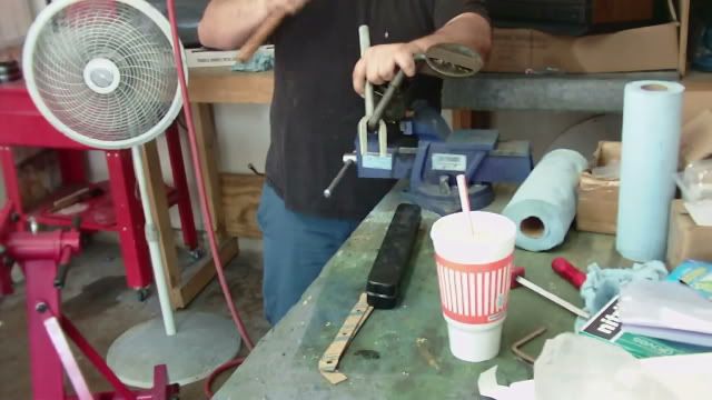

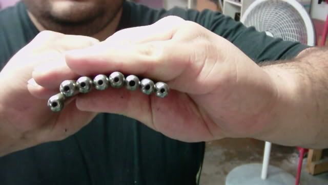

I was gonna install the rocker arms but then I found this..
Look at the first four on the left.
It looks like it wore the holes large. Im not sure what kind of problems this would cause. But will wait till i find out.
Other side look fine.

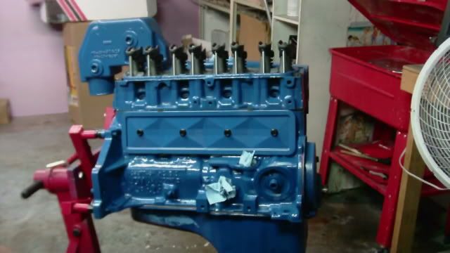

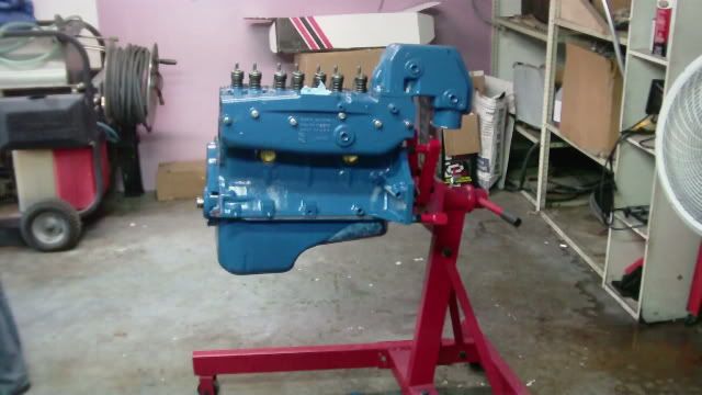

So went ahead and install the manifold.
then the elbow.
Still waiting for the water pump & hoses to come in. WIll prepare the fuel pump, distributor & carb next weekend.

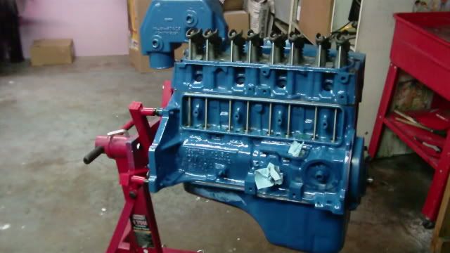

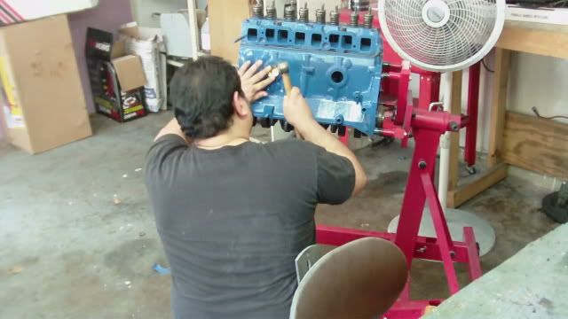

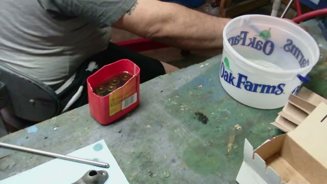

Well it seems i have a set of push rods. They are for a 1970 buick special 251 cid. Believe it or not oreilys had them. So bought them for 19$ vs the 30$ 40 $ plus shipping that marine parts usually are online. The rods themselfs are 5/16 (.312) diameter and 9.68 length. Many early GM vehicles had these. So with my rods on hand I started to bleed my lifters. Put them oil and pump them.
installed lifters, rods & rockers. and rough adjust.
Installed cover and ready for water pump. Hopefully tomorrow.

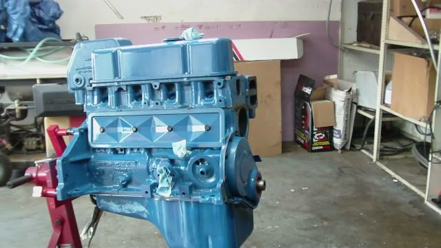

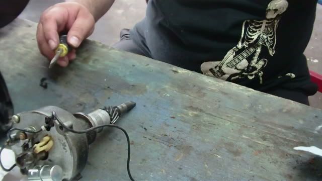

After the valve adjustemnt I went ahead and installed the valve cover.

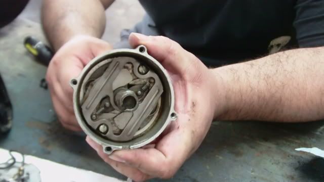

Then went after the distributor.
took the point plate off.
Checked the weights and cleaned the rest of dist. Ready for some rebuilding.

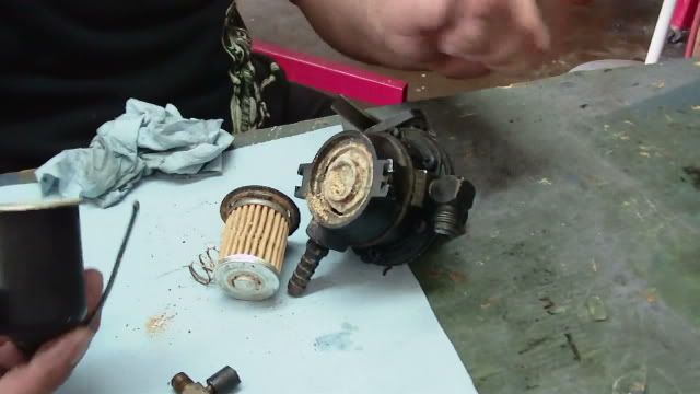

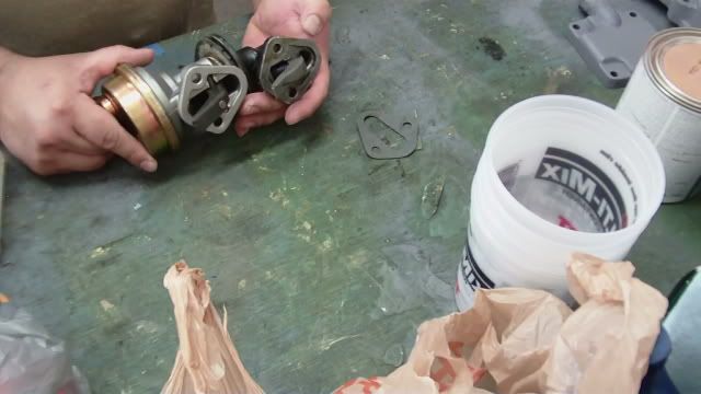

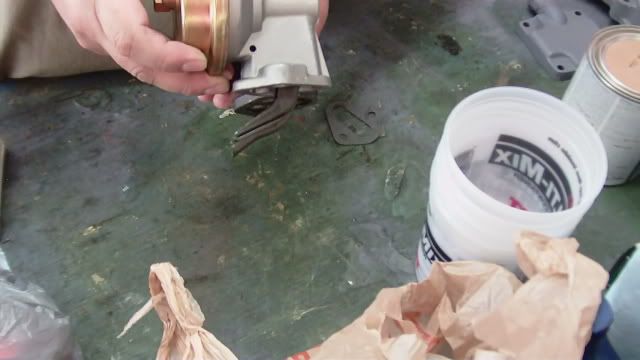

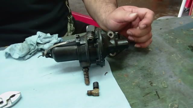

Now the Fuel pump.
Took it apart,,,and this things is nasty!!
Maybe I should just buy a new or amybe I can buy a kit. Will see.

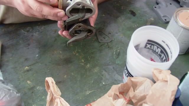

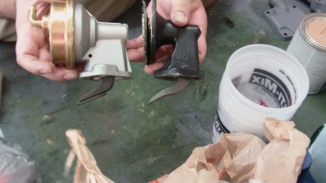

Now i was in the experimentation mood. That fuel pump I have is expensive for a new one. So was able to cross refrence it to a automotive fuel pump!!!. Yeap an automotive fuel pump. I couldnt find a rebuild kit and a new one is almost $100 bucks. Witch some help of my buddies at Auto zone I was able to match it to a 79 nova fuel pump (6 cyl).
This is the part number
Look at how they similarly look.
Now I know that if this doesnt work I will look like a fool. But as always great ideas come from a lot of failures. Marine pump $100 vs Auto pump $22

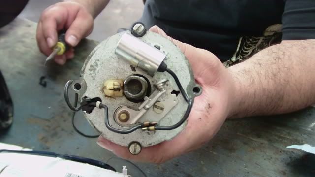

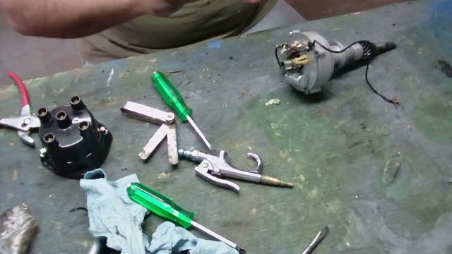

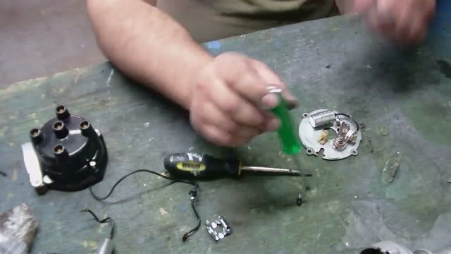

Jumped over now to the distrubitor. Sandblasted the aluminum cover. Nice.
Cleaned the points plate, had a lot hard old grease.
Reasembled with new points and condensor.
Set points at .022" & checked at all for lobes.
Moving on. I thought i would have this thing running by now.
