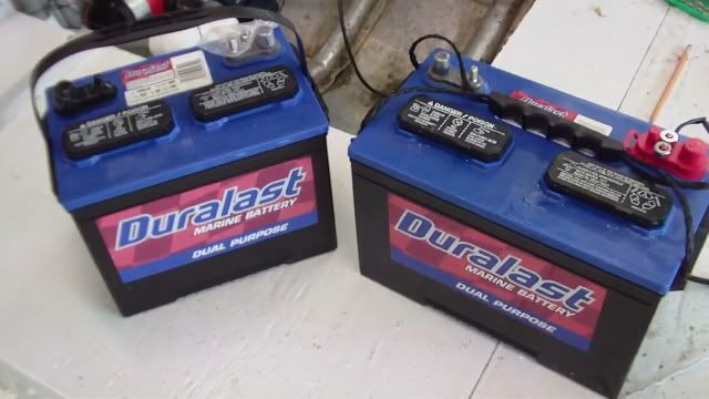

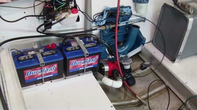

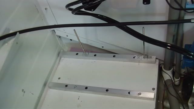

Well, it seems im not having any luck with my engine. Murphies everywhere. To begin with, my cam bearings for some reason fit loosely, wrong bearings. But the machine shop said they would locate some for me but it would be Monday. What a bummer. I was palnning on getting everything together this weekend. So being bummed out i went ahead worked on something else. The batteries. Went to autozone and got me 2 marine battries one for starting and one for the house. $200 and we have a project for the weekend.
So how do I install this. Glad u asked. I had square aluminum tubing left. Measured and cut.
Screwed the base with stainless screws and 5200.
Used rivet nuts again and cut some stainless bolts like I did on the gas tank.
And woala!

Nice job with the battery installation Az. When I switched my single battery to a dual battery set up I went with a voltage sensing relay to automatically switch the motor's alternator output to the house battery once the starting battery reached 12.8V. It was an easy job but I wish I'd done the wiring for this kind of set up to begin with. So I suggest you plan which way you're going to go with the wiring (auto or manual switching) before going much further - could save you some time and effort later. Cheers,

I was thinking about isolators but im starting to be a VSR believer now.

Hmmmm lost?? What is the advantage of a VSR over a isolator? I read a lot about both and seams to have the same out come? Voltage from alternator goes to both and the one fully charge will only go to fully charged? The lesser charged will continue to accept the voltage.... I put in a two battery system with an isolator but.... used a deep cycle for house and a "high crank" for just the boat started. Seem no reason to use a deep cycle for that. Acctually not recomended use for that. With and isolator you can use different type batteries without worrie of deep to high crank, etc feed backs. What did I miss?

Hi grzzz, how do u say that, when i say it it sounds like grease!:) Just joking fool. Anyway, the isolator has the advantage of long life and trouble free operation but many of the diode based isolators are famous to cause a .4 to .6 volt loss which means that the batteries will not charge to as high a voltage as when they are connected directly to the alternator.They are power hogs, thats why they are in a heat sink.
The VSR allows two batteries to be charged at the same time. When the engine is started and the start battery reaches 13.7 volts, the VSR engages, allowing the two batteries to be charged simultaneously. When the voltage drops below 12.8 volts (or the engine is stopped), the VSR disengages, separating the batteries. Havinf a VSR eliminates the possibility of draining the wrong battery and protects sensitive electronic equipment powered from the house battery from harmful engine start up spikes.Thats a very good plus. Please anybody correct me or add to my comment.

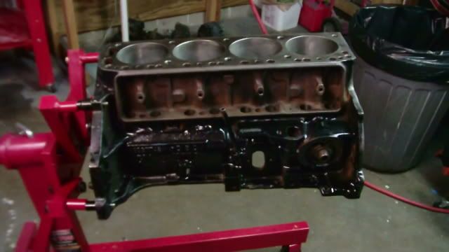

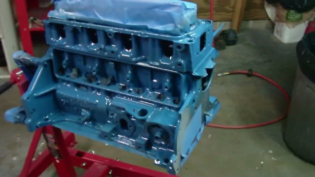

Well, well, well, well, what do we have here. A 140 block itchin to get assembled. Thats what. Finally, after all the hoops I get my 3.0 back in my garage.
He painted it for rust prevention.

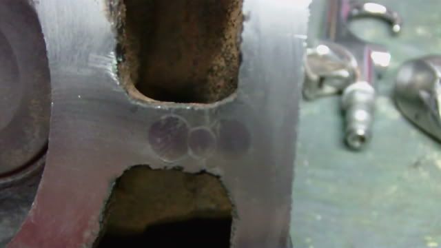

Alos recieved my head with the 3 angle job, crack repaired and decked.
So lets show ya the crack repairs. After looking at the repairs, to be honest, im not impressed. In fact im worried. I just dont feel like it will work, but Im gonna give it the benefit of the doubt.
The block looks better. I do remember seing the crack here.

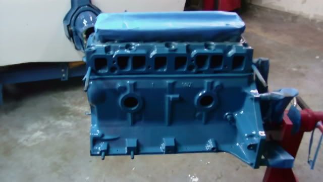

My plan is to go ahead and rebuild another or install a diffrent size. But this season this will suffice. So I went ahead and started to tape the engine for you know what.
Used rustoleum high heat primer.
ANd here we go, Royal blue rustoleum.

I was diggin' it till the valve cover. Not up to your usual standards. I think it would look cool if you just painted the whole valve cover that lighter shade. Glad you got your motor back.
