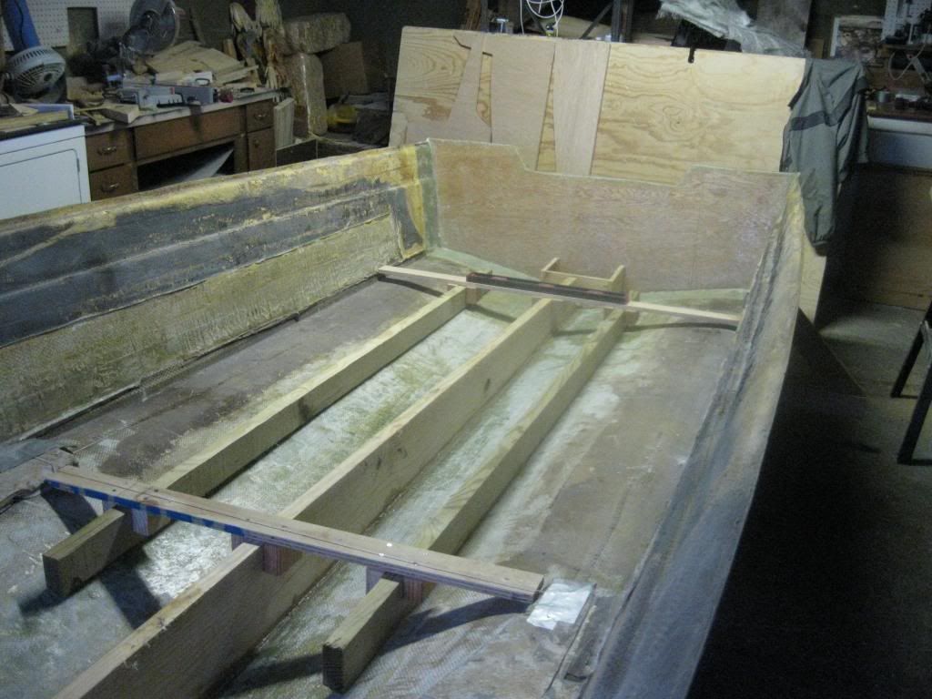

This is a proper stringer set-up for a tri-hull, the very deep keel stringer for hull and deck support and the 2 smaller for hull and mainly deck support. You can visit this thread here:
http://forums.iboats.com/boat-restoration-building-hull-repair/my-project-74-ebbtide-584261.html
Filling your bilge with expanding urethane foam will also help support your deck and will eliminate/displace that pukewater you have... but proper stringers are the most important part of a good fiberglass boat build.
