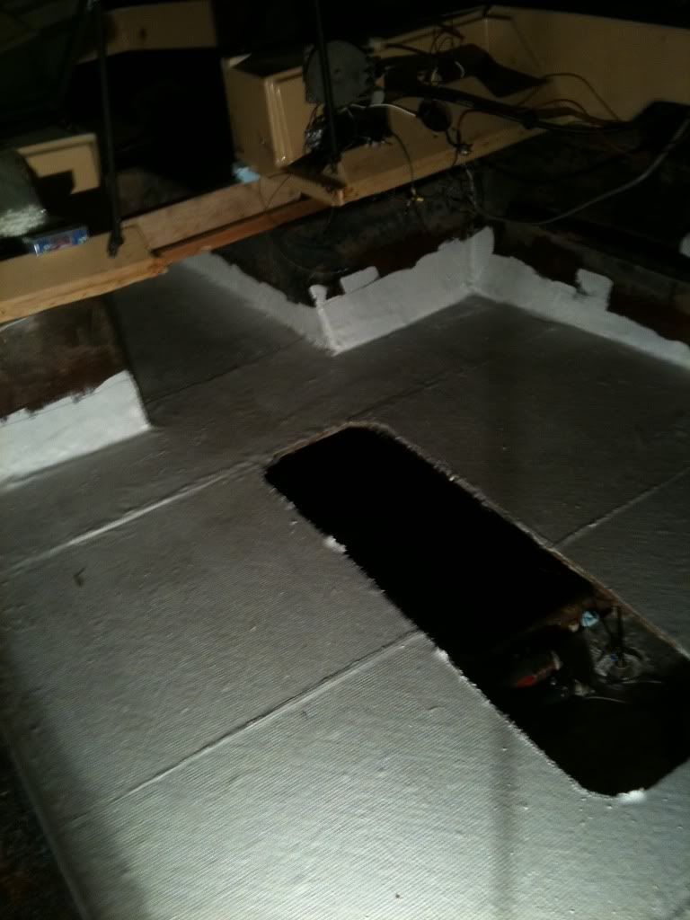

Floor glassed in... 8 hours later :eek:
Definitely will need some grinding before th gelcoat... I hate grinding...
Here's the floor glassed in and waiting for grinding and gelcoat

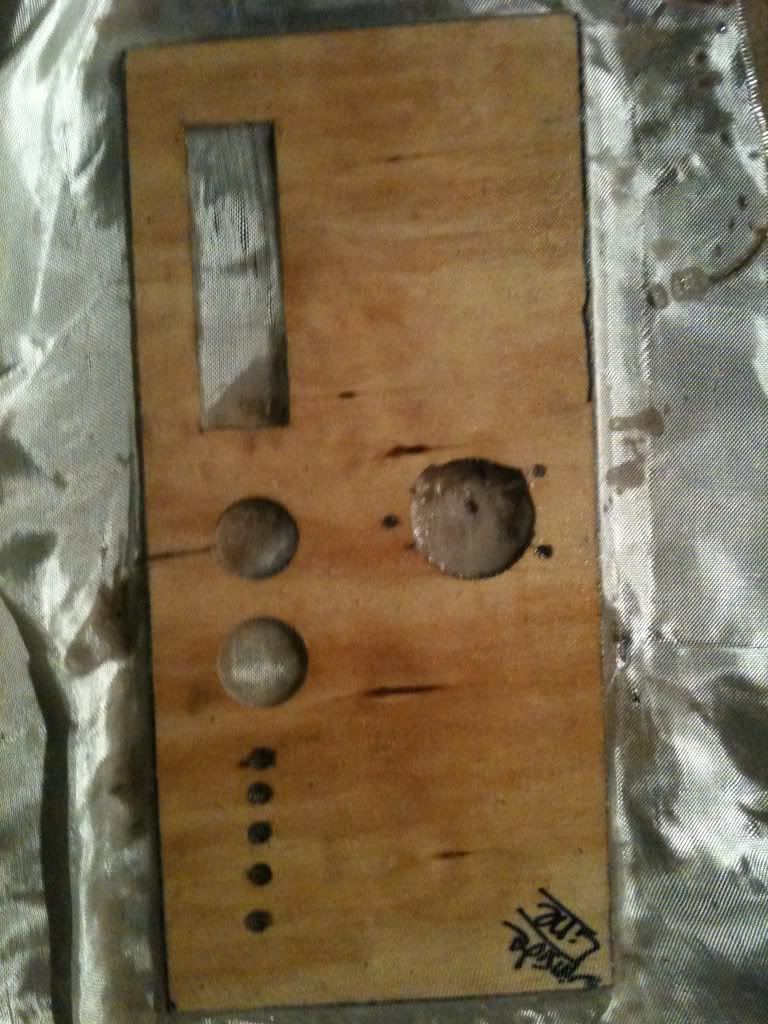

Here's the dash cut out and glassed, waiting for gelcoat. The two big holes are for volt gauge and fuel gauge... rectangle is for VHF and little ones are for switches

So, long story short, my buddy had to run and I didn't want to do the gelcoat alone, so hopefully he'll be able to come back later and roll it out wth me. We did do the dash panel though and it looks kind of.. well... like white bondo. Hope the second coat looks better!

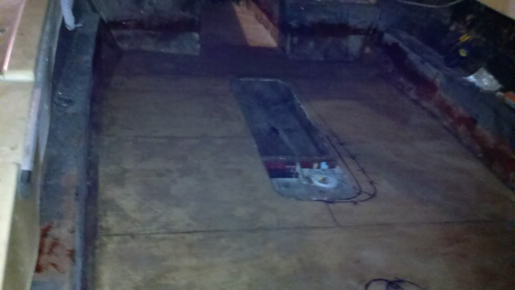

I think we're going to do 3 coats of gel.. The first coat came out OK.. you can see the seams and some bumps, but it's not a showboat.. It was thinner than expected... can we thicken it with cabosil or is that a terrible idea? We can't step on teh gelcoat now, right? any other suggestions are welcomed... A little underwhelmed with how this layer turned out :(
