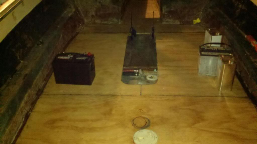

Yesterday was just one of those days that really made me want to give up :mad: First, I went out to the garage to start putting in the fuel tank (with 6 gals of gas) I tested the sending unit and thank god, it still works. I go to grab my drill and see that it's covered in a bunch of white stuff. I have no idea what it is, but my drill is totally dead. None of the buttons would rotate, the torque selector was stuck. It was gone. So I ran to sears (I wanted specificallly a new craftsman 19.2 v drill just like the one I had) and picked up a new hammer drill for 80 bucks. I went back, put the tank in to fidn out I was out of OB oil. SO I had to run to K mart but all their oil was expired and the gas station "2 cycle oil" was for air cooled engines only. So I drove another 40 mins to wal mart an dpicked up a gallon of oil. ALl said and done, I ran the motor and it was dying in idle. I gave it a few low speed carb adjustments and I think I fixed it. Then It was time to "glass and gelcoat the floor" (that was my goal for yesterday. Howeve,r I got a late start with all the drill issues and so forth so I changed my goal to be just glass in the floor. I go to test fit section 2 of the floor and it doesn't fit and the wood warped. F*&^!! I trimmed teh wood downa nd it was just all messed up. I had 1/2" gaps and 1" overlaps and it was just a mess. An hour of measuring and jigsawing later I got it to fit, but it didn't fix the warp. I tried paddign the stringer with wood that I was going to glass on and leave there, but nothing helped except clamping the wood. So I PB'd the outsides, clamped and weighted the wood down the way I wanted it and waited for the PB to set... and waited... and waited. It didn't set at 130 AM so I threw in the towel and called it a night. I went out this AM first thing and it actually looks like it held up pretty well. I'm not steppign anywhere but in the ski locker and on the gunwales until I get it fully glassed in, hopefully tomorrow... and that first layer of gelcoat. It just really sucked having to re-do things that I thought were done.. cutting and measuring and precoating.. I think that the resin caused the wood to expand and warp. either way, it was just miserable. Here's a pic of the sole as it is right now, The deck plate was there just for measuring, it's not permanent yet. The front "T" piece is glassed in and strong :)
UH, WOAH!? we can upload pics directly from our computers now!! Cool, thanks Iboats :D
