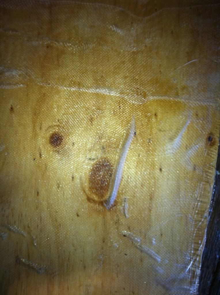

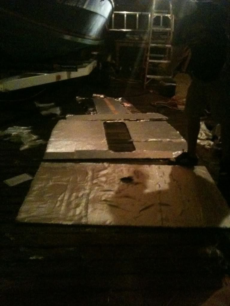

Water, acetone, and vinegar helped. I don't think it came out half bad for a bunch of rookies
This was the pre-cut glass. you can see the ugly bondo and the nice shiny 1708
As the resin is drying

Kinda hard to tell from your pics. did you increase the MEKP mix? You were a little LOW on your ratio. I assume you got that figured out now??? As long as the WHITE is not AIR POCKETS then yeah sometimes resin can cause that color variance. Better pics with more light would help to SEE better.

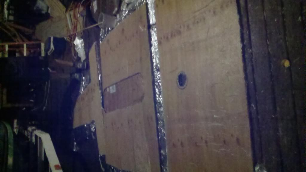

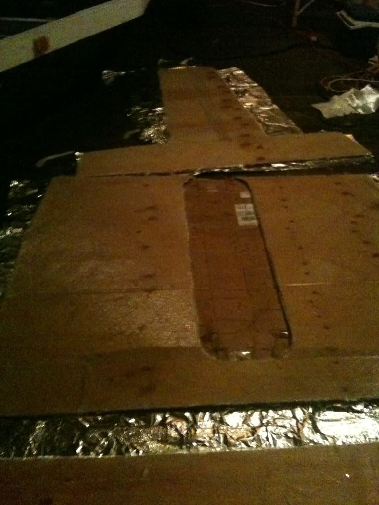

So I woke up this AM and RAN to check on the glass! The bondo has a few air pockets which I expected.. I found it very difficult to work with. is this OK since it's on the bottom?
This is the bi ax, I think it came out pretty well, right? It feels pretty solid, but the ski locker piece of wood still has some flex to it.. It's a U shape and I'd expect the whole thing to move like a board if you pick up one side, but the other side flexes down a bit... A little concerned about this.
