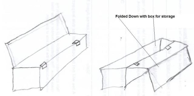

This drawing is what it is but hopefully you get my gist. aluminum frame coverd with Ply or 2x2's Epoxy coated wood, 1/2" plywood and you could Paint or Try out your upholstery skills. Folds forward to give access to gas tanks and battery plus gives 10-12" storage box. Just my idea. For what its worth.
boatguy94
Jul 29, 2009
520
Re: 1978 16' Starcraft SuperSport Resto
Thanks very, very much for the drawing WNG! That is almost what I was thinking about doing. I think I might make the frame out of wood for right now and I can always change it if I need to. Unless I can find a decent price on aluminium right now... I am going to start playing around with the bench tonight.
