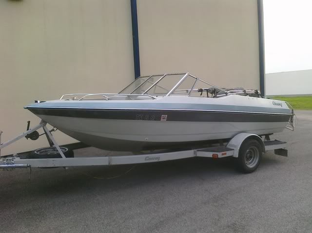

Hello All,

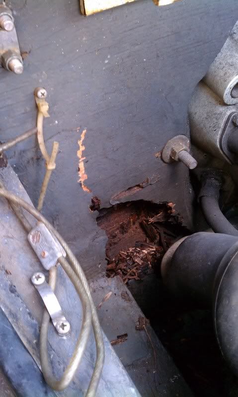

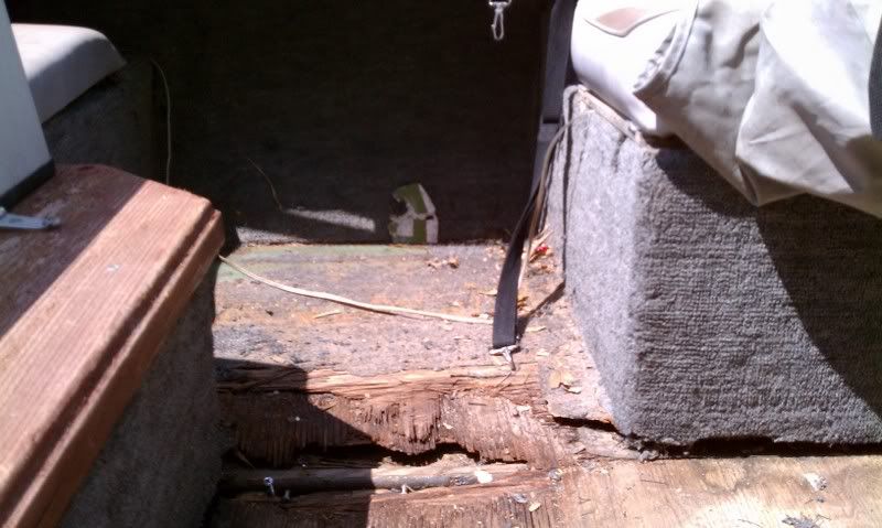

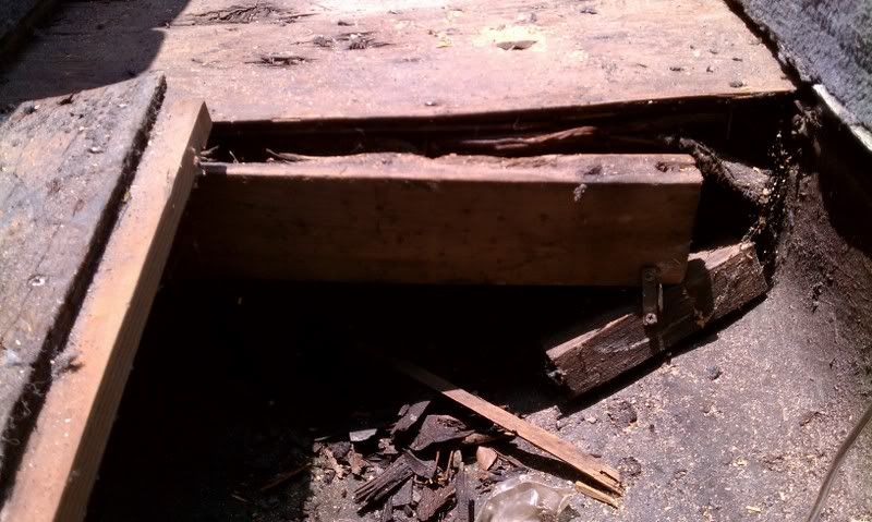

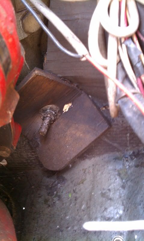

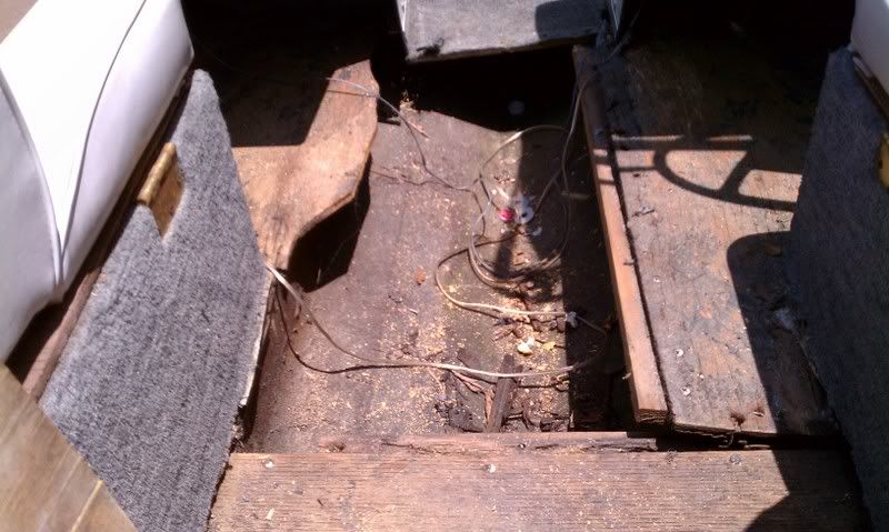

I am at the starting point of a restoration of an 1983 Glastron Conroy X17 I/O - my wife and I received it as a gift last year. I suppose my father-in-law either doesn't like me very much or thinks we have too much time and money on our hands, haha. I am currently planning on replacing the transom and sole, and suspect the stringers will be needed as well. The excellent postings on this forum have been very helpful to date. I have several questions and such, but first some pics:
The money pit:
Pics of the damage:
"ski locker" removed:
ski locker "support":
transom:
transom 2:
sole, or lack thereof:
My current plan is thus, and I welcome any comments/suggestions/etc:
1. Remove cap and gut interior
2. Remove outdrive and motor
3. Rebuild transom, likely stringers and deck. Not sure on foam but will likely go back with new foam
4. Reinstall motor and drive, including needed repair/maintenance
5. Reinstall cap
6. Go boating!
I will be trying to balance cost and quality on this boat, so I will have to fight the urge to overbuild everywhere and just get the needed work done without trying to make the boat ready for another 30 years.

Just a quick update from an hour or so of work this evening. Was able to remove all the remaining electrical and mechanical from the hull, and stripped all the carpet out of the boat. Amazing how dusty/moldy/disgusting that stuff can get! I was also able to get a pretty good look at what I am dealing with in terms of removing the sole.
Carpet gone!
Slight close up, sure looks all of it's thirty years - soon to be brand new again:
And now a request for some input. I have read in several threads where folks made a cradle for their hull while removing/reinstalling the stringers and sole due to flex. I am considering making a cradle and pulling the hull off the trailer to perform this stage of the rebuild. My other option would be to reinforce the existing support from the bunks on the trailer. For those of you out there who have done it either way, or without any bracing, would you recommend your method? Anybody who regretted their way of handling this task? I plan on taking tons of measurements to ensure the cap will fit back on. I may even replace the stringers and the area of the sole that the cap sits on, then replace the cap and finish the sole install. Thanks for any advice!
