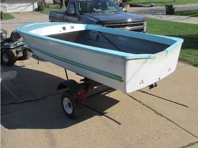

Ok ..... I know it is not a great shot but here she is with her first coat on. I am going to let her sit till morning and then I will sand her and start the second and hopefully the third coats. I painted the lower rub rail the same as the cap but not sure if I like it or not. The green is frog tape. I still have some white painting to do on the transom that is why it looks like that. I know I said this when I was painting the hull but I have to say it again ....... I will never make it as a body repair man. You sure see how well ( or how bad ) your sanding skills are when there is paint on ..... lol.

I like the Splash Rail painted Blue!!!! From what I can see, she's looks pretty good in her 57 Chevy Blue Dress!!!!

Hey Jon, you say you wouldn't make it as a body man...I do it for a living, and let me tell you, there are guys doing this kind of work that don't come close to doing as nice a job as the one you are doing on your MFG...Like in all things in life, when you do it for the first few times, it is a learning curve, when you've done hundreds of times, you actually start to refine your techniques, and finally after thousands of times you are getting pretty close to knowing what you are doing...
If I remember correctly, you are in the same boat as most of us, this being your first restore...you are doing a fantastic piece of work...like those first few scratches and dings in the once new car or truck, after a while they become marks of pride from battles fought and survived...such are the little imperfections that creep up in our first few attempts at doing anything...
Brother, you are doing excellent, commendable, and inspiring work...Keep it up!

I like the blue rub rail also when you pull the tape off it's gunna look good ! Just a little accent color.
Nice job Jon!!:)

I haven't looked in on this thread for quite awhile and I gotta say its come along way. It looks awesome with some color on it Jon!! Keep up the good work your rounding the corner.

Thanks GT for the positive comments ..... as we all know they sure help in the motivation dept. I have a massive amount of respect for you guys that do that for a living. You have a very special talent.

Thanks TDF ... Seemed like I would never get to that corner .... lol.
Woody, fst and sp ..... looks like you guys made it unanimous the blue rail stays.
