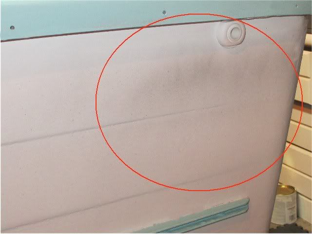

I touched up a few spots on the cap that had to be sanded before the final coat and I used a rattle can of primer and I have a little over spray on the hull. Can I just wipe this off with Acetone or will that dull the area that I wipe? Not sure how to get this very light mist of over spray off without ruining the paint job on the hull.

I would try a small amount of rubbing alcohol on it. Apply to a soft rag and rub gently in a circlar motion.How long has it been since you did the paint job? I'd leave it be until the paint job is at least 3 to 4 weeks old. Hope that helps.

Thanks ED ..... I am going to give the alcohol a try. I painted the hull in October.

Got any Clay??? If you spray it with soapy water and use some clay on it, it will come right off and not hurt the paint at all.

Clay????? What kind of clay? That's a new one on me. Do you use it like you are wet sanding it?

That's crazy ...... I must say I have never heard of that. I guess I will go to the parts store and get some of that stuff. Thanks for the tip and the video.
