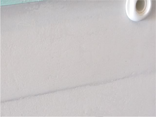

Tried the clay bar today and this is what happened:
This is what I was trying to remove:

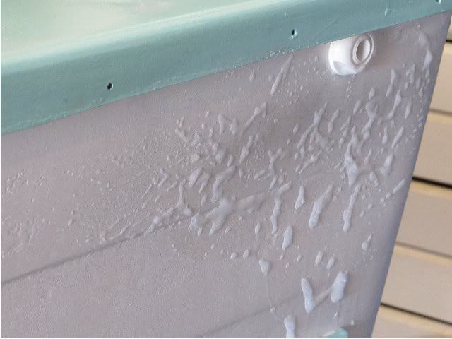

I mixed dish soap with water and put on a generous amount:

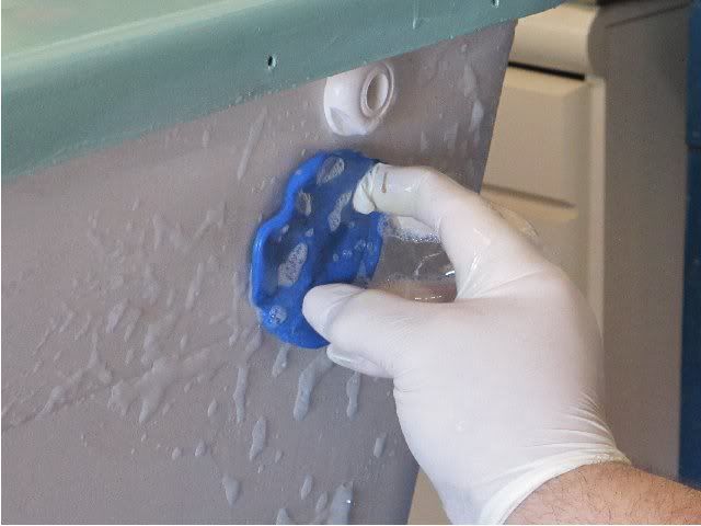

Used the clay bar and kept rubbing until the soapy water was gone. I found that the clay was really hard to knead ..... it was very stiff:

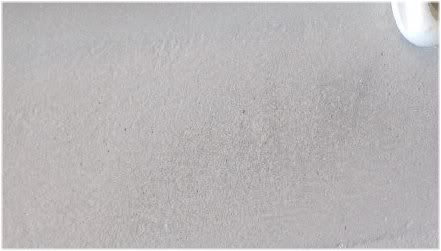

Maybe this bar wasn't what it should be but it didn't take off the over spray:
I wiped it with a little Acetone and it took it right off:

Isn't that clay supposed to soften when you knead it? Slightly? Too soapy? Is that possible?
I think it's only supposed to be a very small amount of soap mixed w/ a generous amount of water. A regular sized misting bottle mostly full of water w/ only like 2 or 3 drops of soap. I think there is supposed to be a very minute amount of friction between clay & paint. Based on the bubbles, I'd guess too much soap & too wet...... That's my take away from the video that WOG posted from the redneck fella....
Anyway, it looks like you got the over-spray off w/ the acetone. Maybe the good underlying paint had cured enough & the overspray was mostly dry (little adhesion) when it settled on the good paint. W/ too much pressure on the rag w/ acetone, thinner or whatever, initially it tends to only loose the sheen in the area you rub down, when you use it to remove surface blemishes. Go too far & it will start to remove the paint.
The area you cleaned looks great!

I think I did have a bit too much soap at first but I kept rubbing until it was dry. That clay was really stiff and didn't soften up very much while I was using it. It seemed like it made the over spray .... I don't know how to describe it ..... kind of looked like a smudge mark rather then over spray. You know when sometimes you try to erase pencil off of paper and it kind of leaves a black smudge mark. That's what it looked like. I honestly think that the clay was old or something because of how stiff it was. I put a very small amount of Acetone on a rag and just lightly rubbed it on the hull and it took the over spray off. I think the clay helped the Acetone take it off so easily. I haven't given up on the clay yet ..... I am going to try it on my truck.
