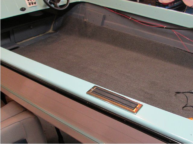

Well, the glue won out over the velcro and snaps so I went and picked up the glue today. I am going to attempt to install the carpet this weekend. Thanks everyone for your input.

Went to install the step plates today and realized that I wasn't sure where to put them. Since there weren't any on the boat before, I kind of wasn't sure if it mattered where they go. Does it?
TruckDrivingFool
Jul 30, 2007
1,818
Re: Need help with transom repair w/pics
Just a thought process - I'd make my best guess at where your seats will be then try and picture stepping off a dock into the boat. That's where they need to be.
Woodonglass
Dec 29, 2009
25,932
Yep ^^^ They should be place to allow access to the boat between the seats.
