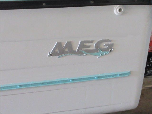

I agree with WOG and GT1M. Put a screw in and don't over tighten them. I would only hand tighten them and use the 3m 4000 you already have on the bolt and nuts.

Ok .... I will use the small bolts. I think you are all right ..... it is added protection. I just hope I don't crack the darn things. Seems like Murphy pops up now and again in my garage and I hope this isn't one of those times ... lol

You won't crack em!!! The bolts are just for backup so only hand tigten...Barely. With the lock tite the nuts won't back off and if the adhesive fails the bolts will keep em from falling in the lake. Heck they don't even have to be tight as long as the nuts don't fall off.

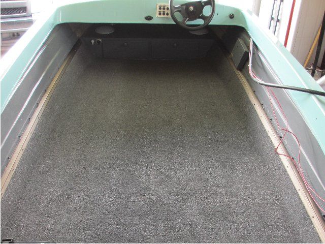

Hey rr welcome back ...... I have been working on it a little at a time but it is getting there slowly ...lol. I did glue the carpet in and it went down nice and smooth. I picked up some aluminum strips at Lowes that were half price because they were bent on the ends so I used them to finish the edges of the carpet.

Ok ..... the emblems are on with the bolts and no cracks. Now that it is done ..... it was a piece of cake ... lol. I have to tell you that was the most nerve racking thing that I have done on the boat so far. I thought for sure they were going to crack.

Man, now I'd definitely lean towards white rub rail insert...... Logo looks fab!

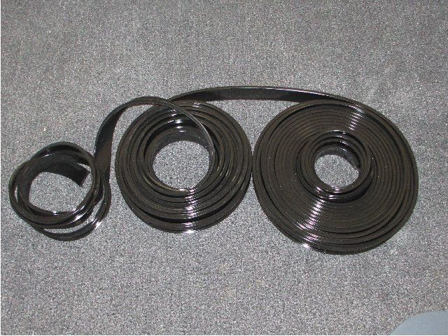

My rub rail insert finally came today ( yes .... the Mrs. decided on black ) and I found it very easy to install. All I kept thinking was how am I going to pull this vinyl thru the rail all the way around the boat.
This stuff is a lot more flexible then the stuff that was in there. I was able to put the insert into the bottom of the rail and then squeeze the top of the insert to force the top into place. I was amazed at how easy it went in.

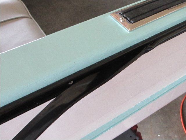

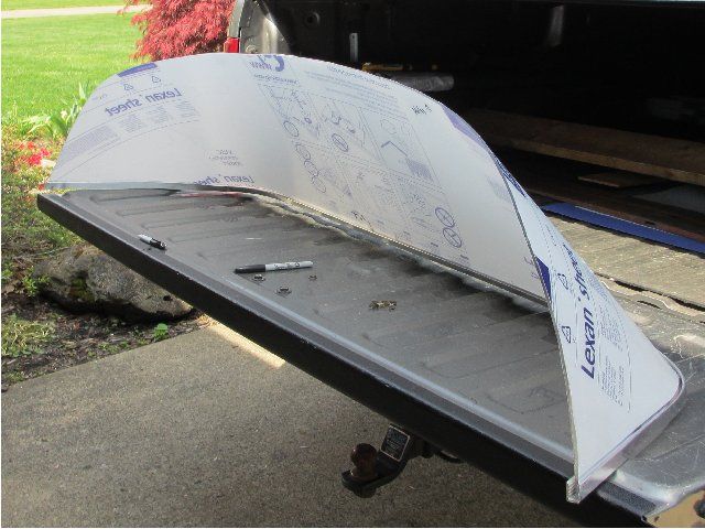

No, you didn't miss it because that is the original trim I am just replacing the old shield with new Lexan. I made a template back when I removed the windshield and it is very close but still a little off. I think it is because the old shield had a bubble in it and this is going to be kind of flat. I had to order the seal that goes along the bottom of the Lexan and sits on the bow .... once it gets here I think it should go on ok.
