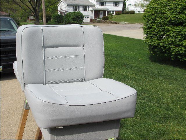

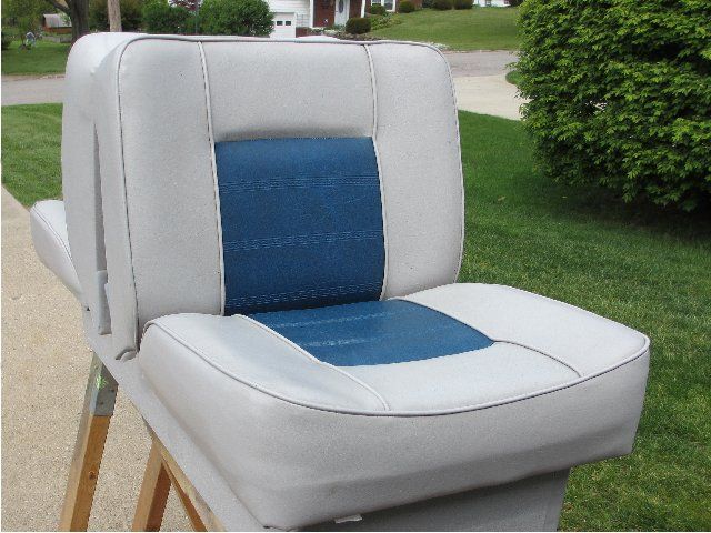

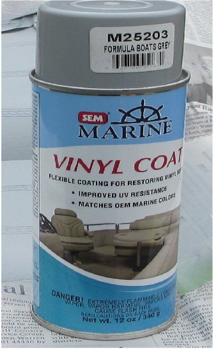

I liked the seats that I have for the boat but the blue trim in the center didn't match anything on the boat so I went out and bought some marine vinyl coat and solved that problem.
Sorry for the huge can photo ... lol.
Before:
After:
I have never used this product so I am not sure how well it will wear .... time will tell.

Looks like the color matched perfect. They didn't have a light blue color?
Hey sp ... they didn't have a blue that I thought would match so I stuck with the grey. I figured I was safe that way ... lol.

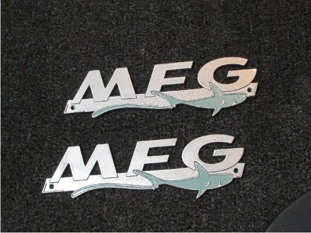

I have a question that will probably seem dumb but here goes ... I am going to install some emblems on the boat and the instructions call for using "100% pure silicone caulk". What product is 100% pure silicone caulk or what can I use that is similar? I have some 3m marine adhesive sealant fast cure 4000 UV .... will this work? Thanks.
Woodonglass
Dec 29, 2009
25,929
Re: Need help with transom repair w/pics
Yep 3M is 4000 or 4200 is what I'd recommend. Silly-Cone is NOT for boats!!!! :p
jbcurt00
Oct 25, 2011
25,165
100% pure silicone caulk is just that, 100% silicon w/ no other caulking compounds. Not latex modified silicone caulk or a silicone additive in regular caulk. Those are combinations of "normal" paintable caulking w/ some level of silicone added to improve it's weathering or exterior applications performance. Pure silicone resists the adhesion of paint, so to make exterior silicone caulking paintable, it's blended w/ some other caulking compounds.
HD & other big box stores, wally world to maybe, should have 100% silicone in both smaller squeeze tubes & regular caulk gun tubes....
If you have the 4000 UV, I'd probably use it....... Or expecting to use it elsewhere, I'd grab a tube of 4200/5200....

I have a new tube of the 3m 4000 so I guess that is what I will use. I ordered emblems from mark42 and they are made from poly resin so I wasn't sure what to use to install them. He is the one that suggested using the silicone.

ON the emblems you might consider drilling and screwing. My Lonestar emblems have Posts on then that go thru predrilled holes in the hull sides with compression clips holding them on. I would not want to trust them to adhesive alone. JMHO.
Hey Woody ..... that was one of the things that Mark said when I ordered the emblems was to not use the screw holes because it will crack the resin.
Here is the message that I received:
"DO NOT USE THE TWO SCREW HOLES TO MOUNT THE EMBLEM!!! The emblems tend to crack if a screw is tightened down on them. If you put a screw through the hole, do not tighten!!!
How to mount them to prevent any damage during use:
Clean the area where the emblem is to be mounted. Sand the area with fine sand paper, like 150 or 220 grit just to give the gel coat some 'tooth'. Also lightly sand the back of the emblem. Apply 100% pure silicone caulk to the entire back side of the emblem about 1/8" thick. Press the emblem to the boat, and use masking tape to hold the emblem in place. Some silicone will squeeze out. Leave it alone for now.
AFTER the silicone has cured, trace around the emblem with a razor blade and then pull off any silicone that may have squeezed out. Trying to remove the wet silicone will just end up with a mess.
This method will keep the emblem from being caught on drying towels, polishing rags, etc that could pull and break the emblem during cleaning of the boat. Try to get full contact of silicone on the entire back side of the emblem, especially on the F and G letters".
So ..... what do you think?

I think I'd use Small Stainless Bolts and some 3M 400. I would "LIGHTLY" tigthen the bolts and put Thread Lock on them just as a precautionary backup in case the adhesive failed. But... maybe I'm being to anal here.

You think a pop rivit would break it?

Nice looking Logos...Do as Mark said, but just take the added precaution of pre-drilling for the screws, install them with a little dab of 5200, lightly tighten them down...cheap insurance to make sure they stay put...
