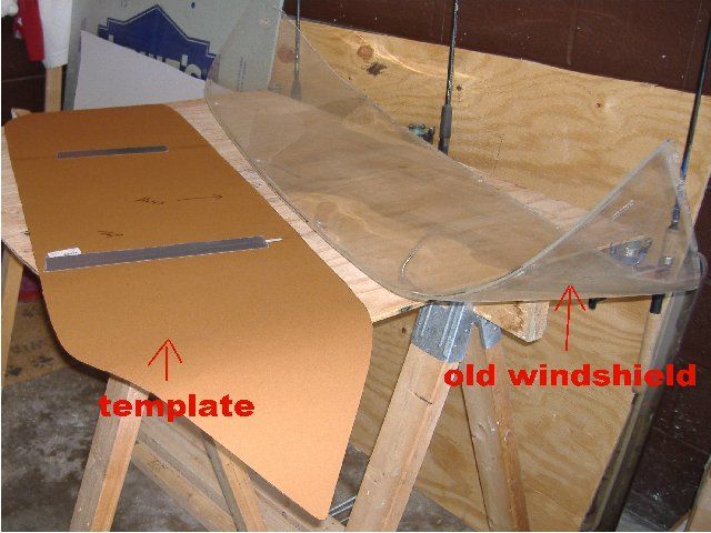

First I made a template of the old windshield out of paper:

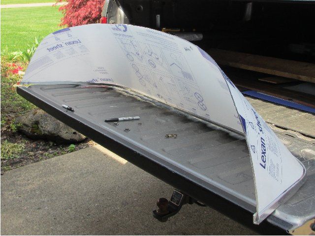

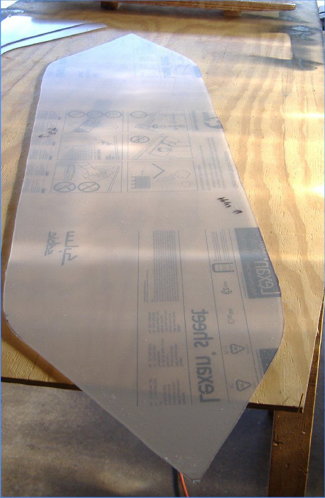

Then I traced the template onto 1/8 Lexan and cut it out with a jigsaw and a very fine blade:
Then I forced it into the old frame and put in some screws and rivets to hold it in. I also put a bead of 5200 between the Lexan and the frame to seal it:
Then, after what seemed like days of trimming and cutting, I was able to get it to lay down kind of close to where I needed it and I bolted it to the bow:
I think because the old windshield had a sort of "bubble" in it my template was off a bit which caused me to have to trim and cut to get it to fit.
