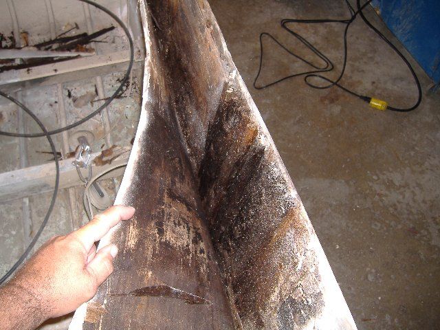

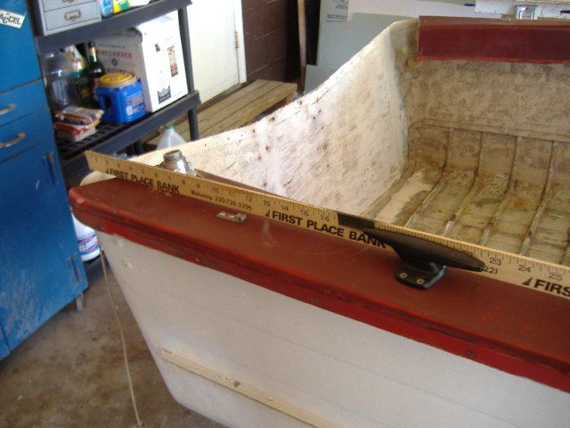

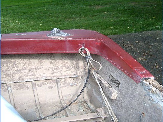

Hi Boatgoat ..... Yes I did remove the inner skin and I removed the ends of the cap instead of the whole thing.
Here is where I removed the inner skin of the transom and found mush instead of wood:
Not sure how your cap is at the transom but here is how I cut the cap at the ends:
This is how my cap ended at the transom:
It was a fun little project with some unexpected surprises but it was worth all of the work. Feel free to ask any questions that you might have. I am no expert but I will be glad to help as much as I can.
