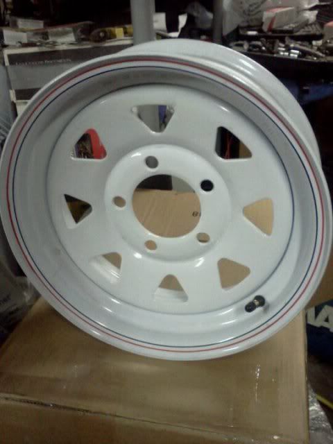

Youd have to probably look at my first pictures to see them but now that the trailer is looking all purdy the black steel wheels needed to go and I wasnt about to go the hubcap route :D, anyways..... was searching around on eBay today, found a pair of 13inch white spoke trailer rims for $31 delivered ($31 for two :eek:). They had other sizes, sounds like most have some cosmetic blem but nothing serious...... can search for this to find em.
13X4.5 5/4.5 White Spoke trailer Camper Wheel / Rim
Rims got delivered.......

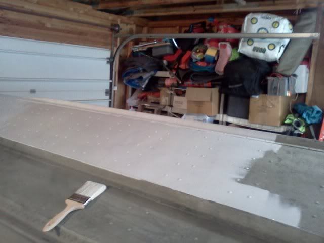

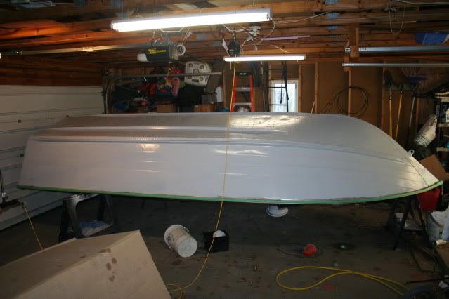

Ahhhh, Rustoleum fumes. :D Finally after all this waiting on stuborn ma nature I got some paint down.
The gray is the color I ended up doing on the entire boat, Its two quarts of Gloss white and one quart of smoke gray rustoleum pro mixed together, then its going to have the factory stripes like my avatar in blue. I also added a little Majic hadner to the paint, figured it cant hurt if it speeds up the dry time and makes it tougher. http://www.majicpaints.com/detail.asp?product_number=8-0950

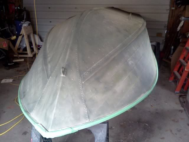

Duplicolor zinc chromate primer on.
Paint going on.

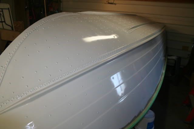

I dont know who the fat guy is that got in the picture. :D
I think my camera lies because it didnt turn out this good, Im happy with how the paint is going on but these pics look amazing. (If the camera makes the paint look this good I wonder how much worse I look in person :eek:).

Man that paint job looks beautiful! Super sharp! So I'm not seeing any sprayers or rollers, ya just brush it on?
Excellent bro!!:D:D:D

Thank Jason, its coming along. I did roll it on with a 6" foam job and then hit it with the brush.

Paint is looking great! :D Wish mine was that glossy...

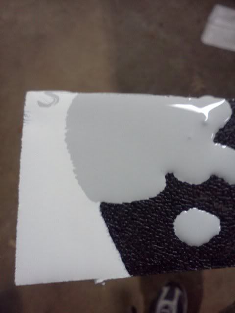

Stripes went on today. Did another fingernail scratch test on the bottom of the boat today, couldnt get the paint to lift no matter how hard I pushed in.
