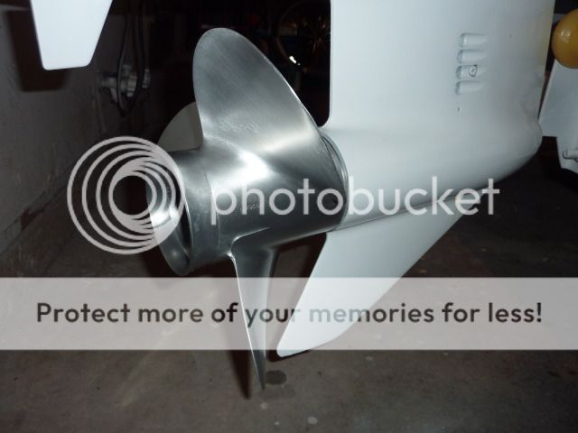

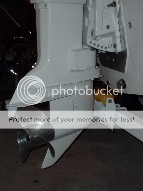

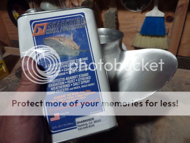

So I really wasn't all that happy with the black I painted the prop a while back. So, this morning I grabbed the KleanStrip in the orange can and went to work. After a while the paint was off, hit it with the read metal sanding sponge, then steel wool, washed down with water and then mineral spirits. Then a wipe with Shark Hide, bolted on...
Much better!!:D

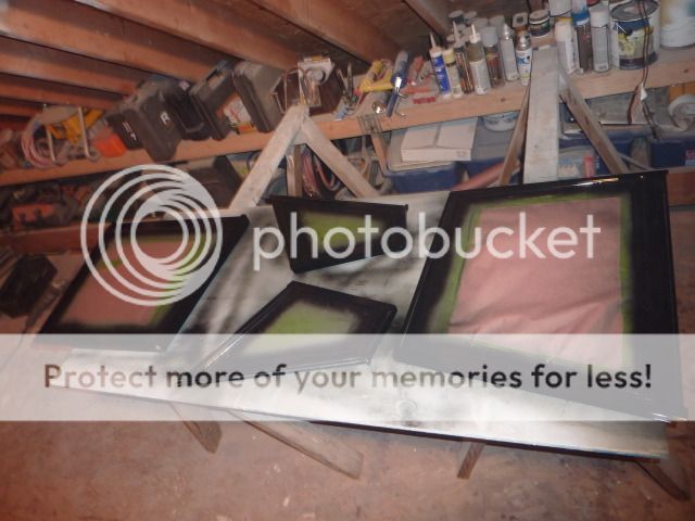

I also taped up (took forever) and painted the windshields too...
Getting there!

That prop looks sweeet!
Well my friend, my budget scoffs at a stainless prop so yah, couple bucks in chemical stripper and a healthy dose of elbow greese did the trick:)
Although this one matches all my "brushed" alum so that's pretty cool:cool:

The windshields really add to the boat. I looked at the first pic of the prop and thought it was ss. Had to read it was alumimun. Really sharp.

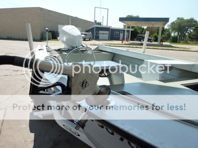

So yesterday afternoon the SN and I went for a field trip. She towed perfect and looked great back there! Here was our destination...
I was amped and had some big plans for today but man if she wont start for me now!:(
She turns over fine but just wont fire for whatever reason. I'm headed out for some new plugs/wires and a spark tester. I think I'll grab a bigger batt too, this one seems kinda wimpy. I'm all ears if you guys have suggestions. I'm one sad kid right at the moment....
