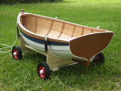

Re: 1999 Celebrity 190 - Engine Mount and Stringer Repair
Looks like a GREAT 1st and 2nd Mate for your Boat!! Congrats to you and the Admiral!!!!!
You need to build em one of these...
Congrats on the family addition :)
I like WOG's idea!!!

I been thinkin...Since the new addition will be takin the Crib, big sister will need a new bed. One of my woodworking buddies made his Grandson this bed...
I think it would go GREAT with the Wagon you're gunna build!!!!!:D
Poor guy's never gonna finish his boat because of all the kiddie-projects WOG is lining up for him! :laugh:
Yeah! One project at a time fellas!
