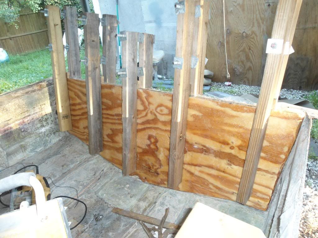

We threw together a set of WOG clamps in preparation for the transom installation . Luckily we had everything on hand to make them . This is just the dry fit to get them as close to adjusted correctly as possible before hand . Hopefully we will be better prepared than whoever was in charge of ObamaCare .. :rolleyes::usa2:
Notice a little addition to the set up . I screwed some blocks of plywood to one side of the clamp to work as a stopper . Just might cut down on the fiddling around getting the clamp height right . Placed up a few inches to make room for filleting the edges .
Chris has been on the night shift this week so I may not glue it in until this weekend .
What's your best guestimation on the amount of resin to have ready for the pb lamination ?
2 qts maybe ?
GT1000000
Jul 13, 2011
4,916
Re: Glassmaster SIL project .
Few tips...
pre-mix as much PB as you think you'll need...2-3 quarts sounds about right...Keep them in three or more separate containers...
the smaller batches will tend to kick off slower because there is less heat generated from the smaller amounts...
DON'T add the MEK-P to them until you are actually ready to use it...
Keep your ratio at about 1%...Remember you are only adding the catalyst to the actual amount of resin...example...1000ML=10ML catalyst irregardless of how much thickening agents you add to it...
Work in the shade!!!
The cooler the temps the better...if possible have the resin and MEK-P down to cooler temps...
Closer to 65-70?...
Have your MEK-P pre-measured for each batch...
Add the MEK-P to each batch as you need it...
Stir it in quickly and briskly...less than a minute should be more than adequate...
Add some 2X4 Braces to the chopstick clamps...like I did...holds everything together and ready to go...also applies more even pressure...
They will be heavy, but less fiddling with them...I like your idea of the plywood stops...
Hmmmmm, what else....uhhhh...Oh yeah, do a couple of practice runs...kind of like a rehearsal...go through the moves a couple/three times then go for it...
Work quickly and efficiently...you should have about 20-25 minutes, easily, before everything has to be in place...
Use the stuff that spooges out to make as much of the fillets as possible...
Once you get it all done and want it to kick off real quick, get some direct sunlight on it...should get hard as a rock in less than 15-20 minutes...
Any left over, un-mixed PB can be stored for a few days in an airtight container for later use...
Oh yeah...Good Luck and Have Fun!:)
As usual , great advise GT ! The thought did cross my mind about adding the horizontal 2x4's . I like it . Good thing I cut the threaded rods long enough for the extra thickness . Our temps are about to change up here . I think it's gunna be a fridged 68 or 70 deg up here so that should help out . How long will the unmixed pb last before it goes bad stored ?
